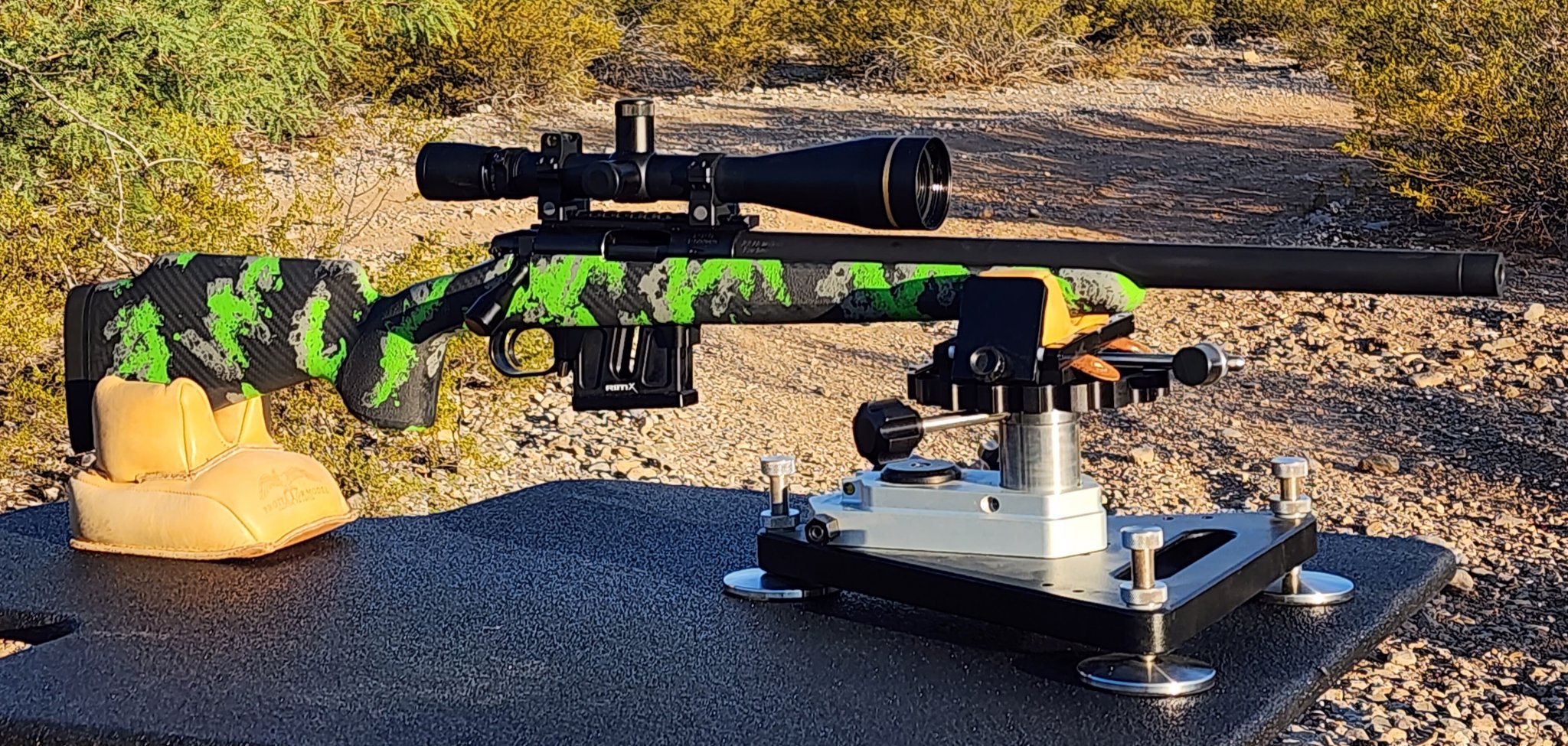

Finally got my Rim-X ready to start shooting. Hoping the Proof barrel works well.

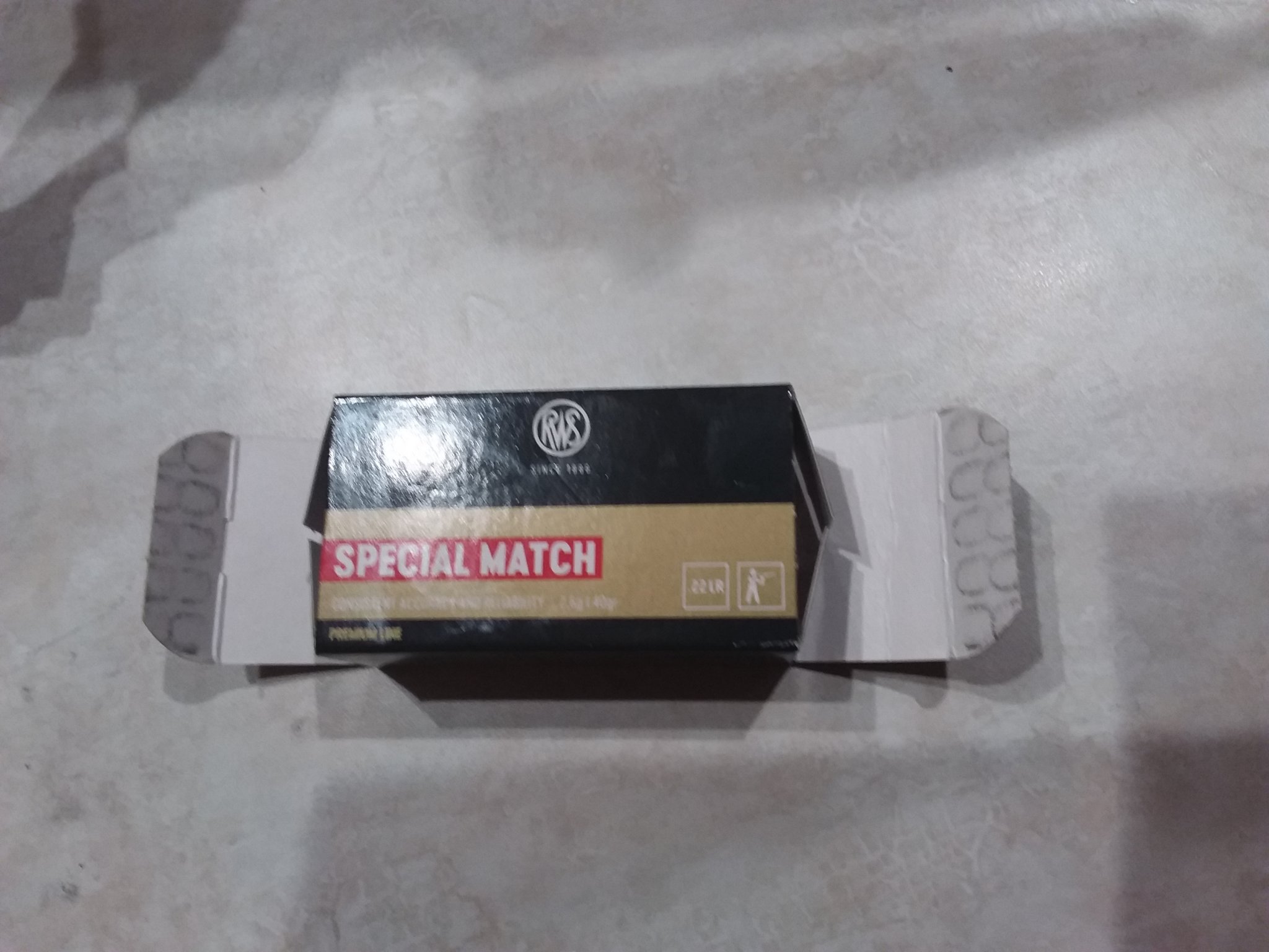

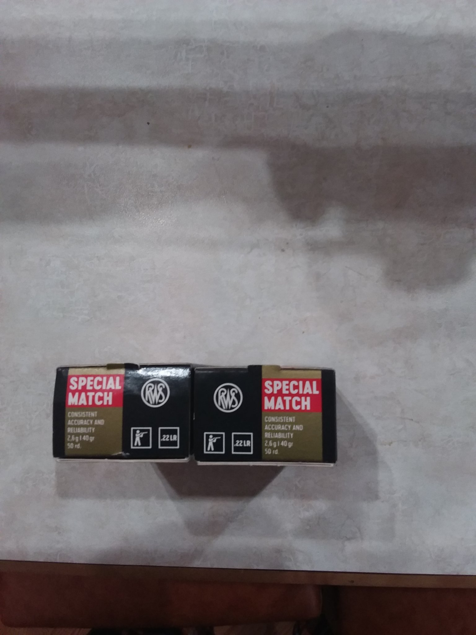

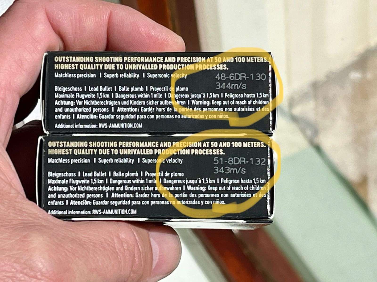

Thanks for your replies but I'm not seeing anything.
Thank you
Thanks for your replies but I'm not seeing anything.View attachment 8265607
Thank you
Pull the flaps out, and it's literally stamped into the cardboard flap on the inside. Only on 1 flap of the box so you have to pull both out to find it.. it's not printed anywhere on the outside of the box like R50
Thanks for the link but was looking for a Rimx logo shirt.
I guess this is one of those instances where " a picture is worth a thousand words ". As mentioned it IS difficult to see but when you finally see it I expect you will be surprised it is hiding in plain sight. It is one ONE of the end flaps on the coloured surface. That portion is "hinged" for lack of a better term. It is on the portion that tucks into the box and is NOT visible when the box is closed up. Sorry I cannot send you a photo.

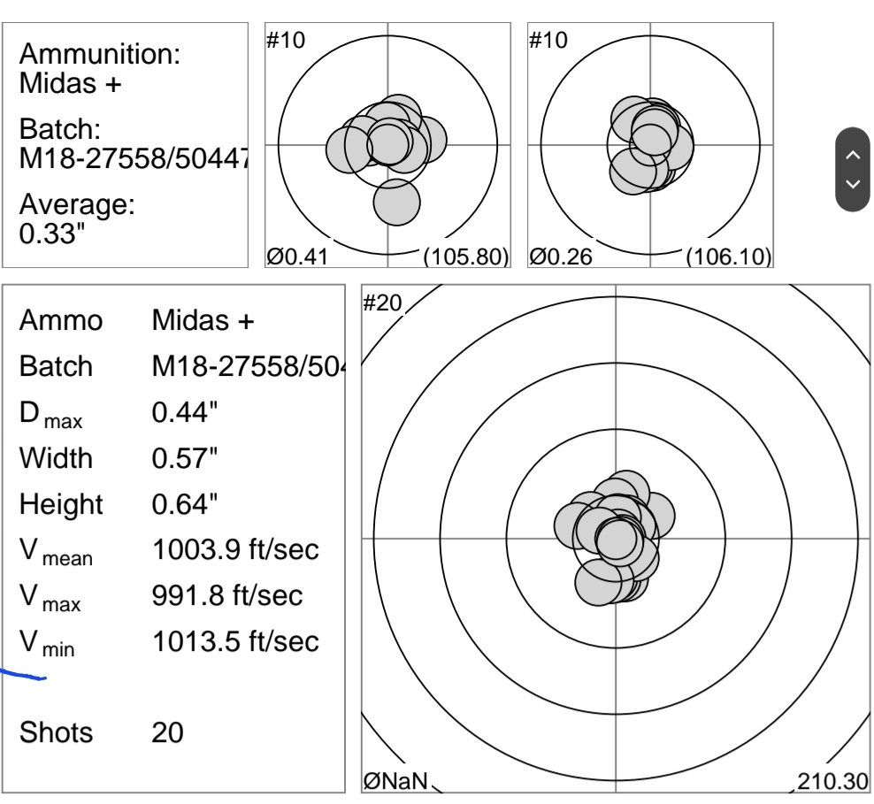

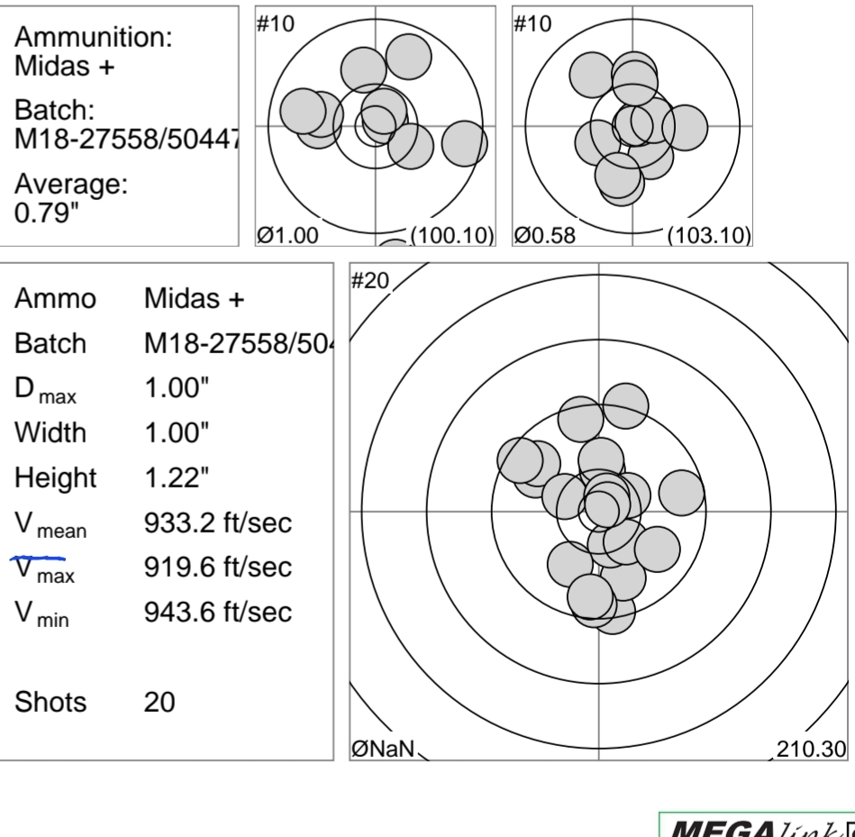

Exciting day at the Laupa Test Center. Ryan Sponauer and I fixtured up my RimX/Mike Manzella barrel and went to work. We shot 9 lots of Center X and 9 of Midas +. The results were examined and few more lots shot to validate. We concluded this thing absolutely shoots lights out! Both targets show two ten shot groups and the 20 shot combined target. Top target is 50 meters and lower is 100 meters.
Looks to be a shooter. Is the thread protector loose? It looks to have a bit of a gap, but maybe its just the picture…
Is that Edge to Edge or C-C? Nice shooting.

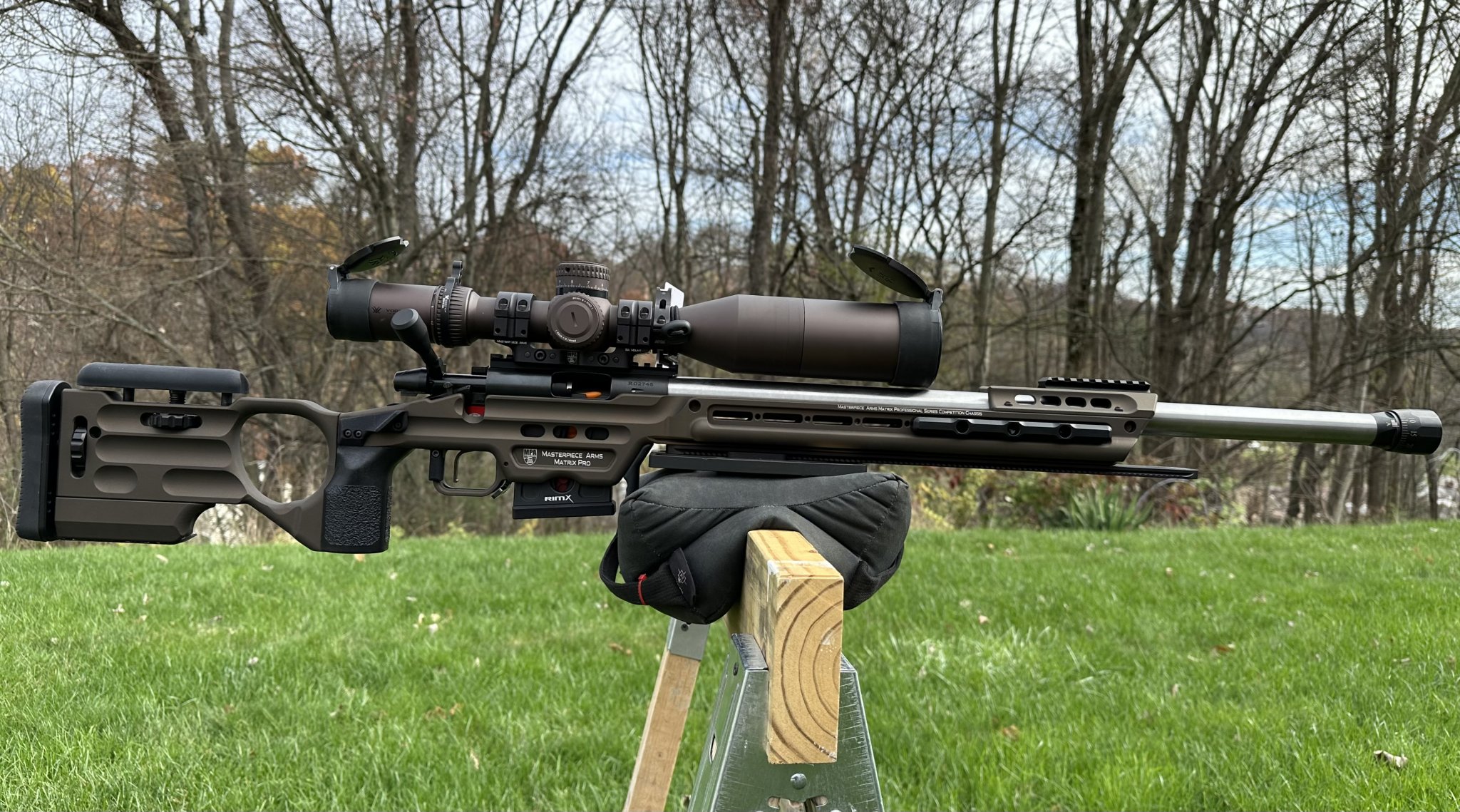

Got out today to test this shilen. Not the best conditions it was off and on gusty but I wanted to get some testing done.
Setup at 100yd from the bench with my NEO and started testing lots. All 20rd groups. With the wind we weren't going to be winning any benchrest competitions but I was looking for what lots of ammo stood out for future testing at 200 and 300yd.
First up was 2 new lots of SK+ and SK RM that I received recently.. the SK+ actually performed pretty well.
Various lots of CX didn't impress at all. Nowhere near as spectacular as it performed in all my other 16 twist barrels. Complete opposite.
Next up I testes a few lots of R50. They performed much better. 2 lots really stood out in these windy conditions.
I have a lot more lots of of R50, CX and SK available to test but I'll probably do some 200yd and 300yd testing on the next calm day with these 2 best R50 lots..
Stay tuned for more testing but I don't see this 12 twists shooting any better than my 16 twists and actually these CX lots shooting worse than they do in my 16 twists.
See how it performs at farther distances next
Just as an update. I got out today, little calmer/more predictable conditions but still 5-10mph off and on wind.
I shot 2 10rd groups of each ammo. Shot 8 different lots/types of ammo with mostly the ones that did best yesterday at 100yd with a few new ones. Another lot of CX and SK+..
My final take aways.... for my second fast twist barrel testing I didn't find it standing out at any distance from 50-200yd compared to all my 16 twist barrels.
It shot equally as well as most my other barrels at 100 and 200. It didn't like CX.. it shot R50 at distance best like most my other barrels.
The best lots of R50 shot sub moa @ 200yd 10shots.. SK+ and CX shot huge groups at 200yd.. RWS Special match.. 1 out of 3 lots shot as good as the best lots of R50...the others shot sub 2.5" groups... all groups I shot were 10 shot groups.
