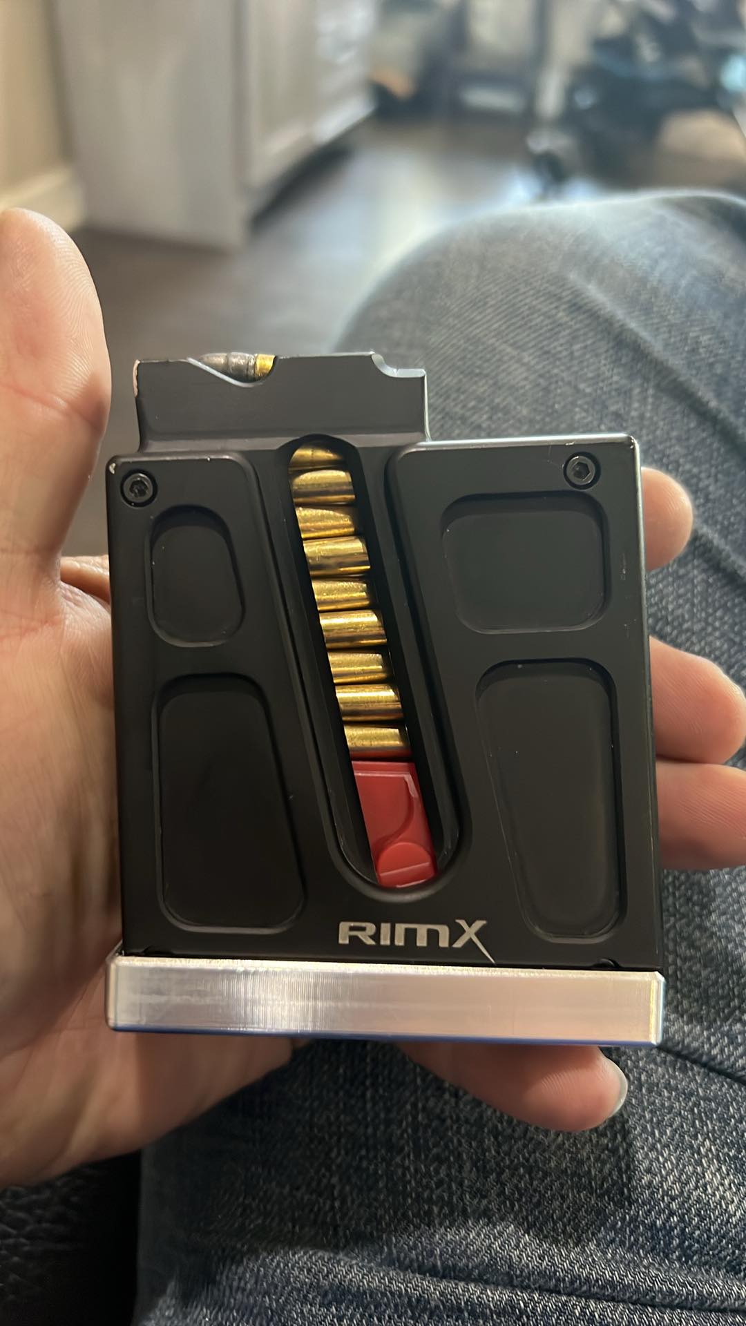

12 round mag? Probably going to "need" this! I like the 15 rounders but don't really like loading them after I can't get ahold of the loading tabs.
I'm not knocking the 15rd mags because I love how well they're made. The 12rd was kind of Leon's mad scientist moment when he wanted to make it keep the loading assist and most importantly wanted it to be the same size as the factory 10rd

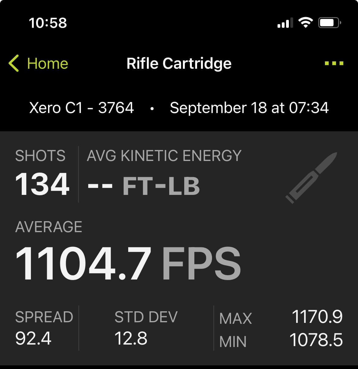

{ chrono summary for 2nd day testing; consistent with 1st day }
