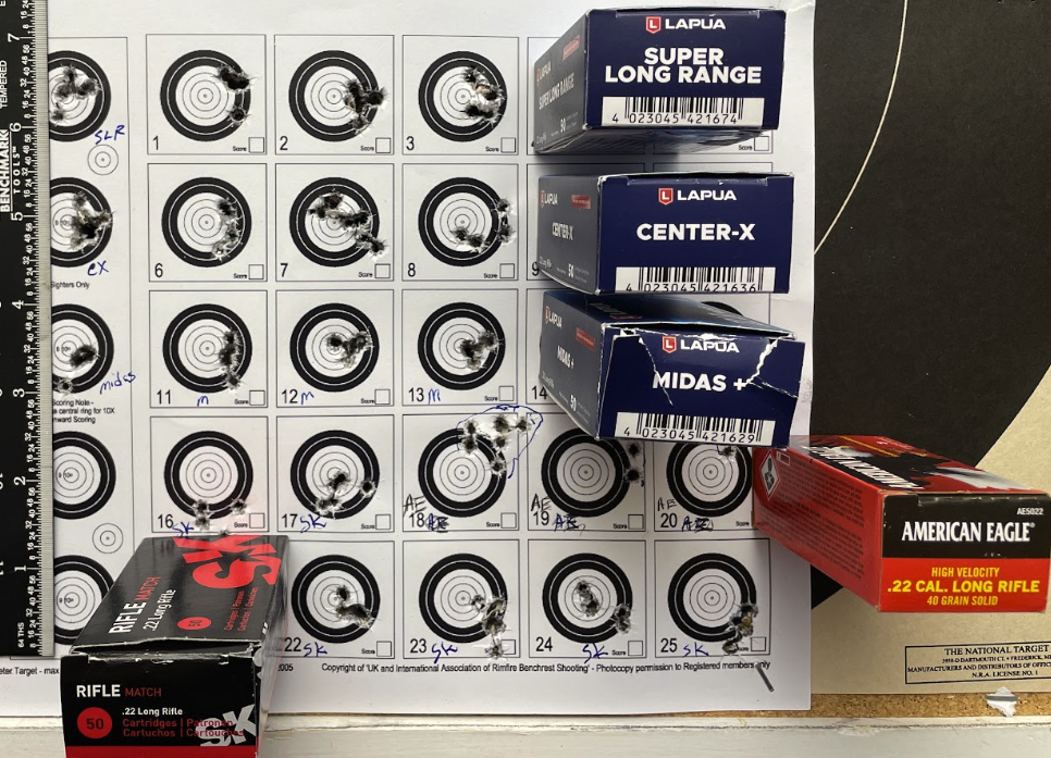

Here's the first target I shot with it, small sample size but seemed to like this lot of Midas+ (3rd row)

none of them able to reliably produce anything under .45". Most of the higher end stuff shot around .5".
just a thought but how are you measuring you're groups? outside edge to outside edge - .223? using calipers?

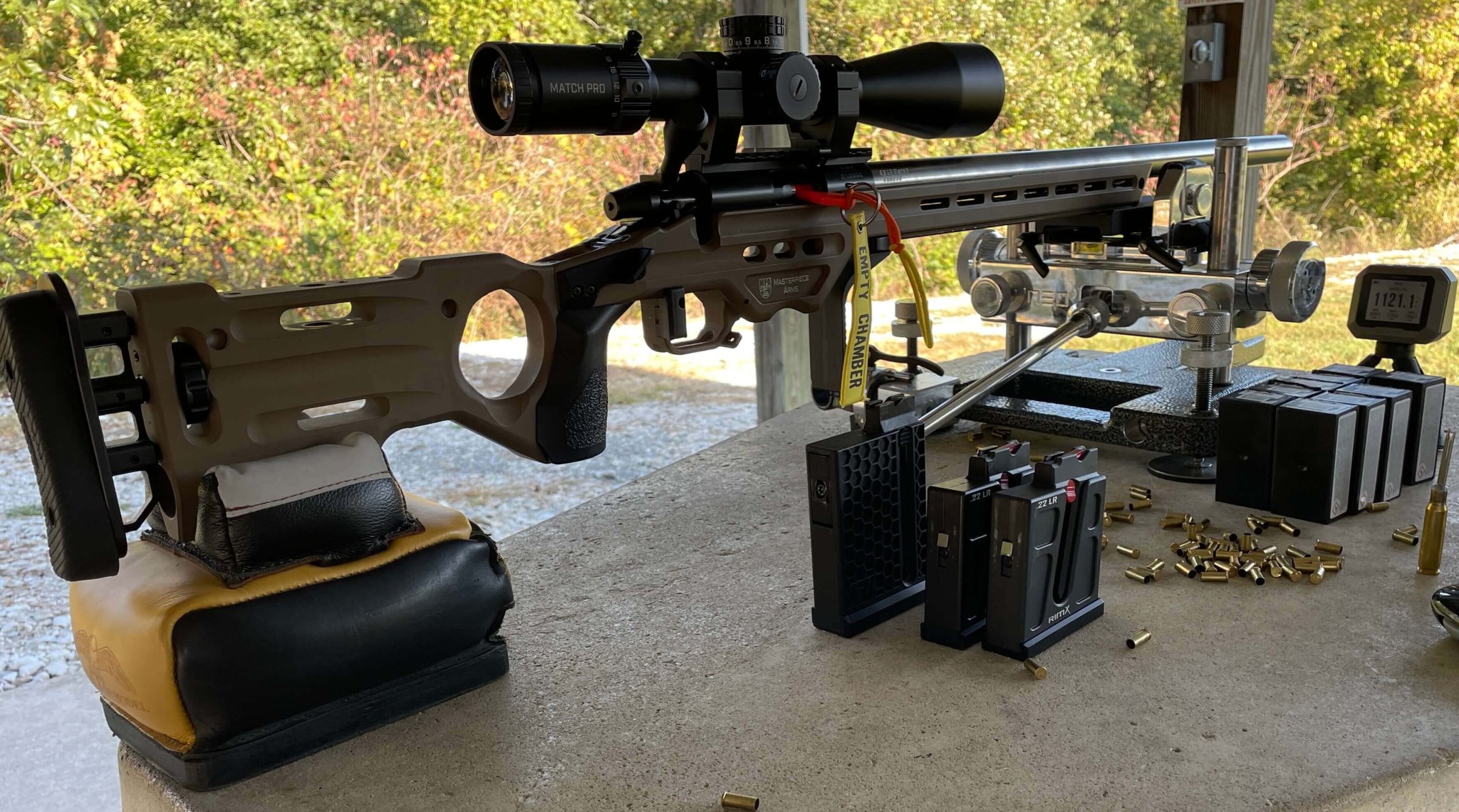

Sorry I didn't post the pic. Here my 2500x Tenex lot testing setup today..
now THAT is a serious setup. Definitely sturdier than mine lol.

Proven and tested in my chamber
All flavors of Lapua
All flavors of SK
Federal Gold Medal Match, Ultramatch and Target (Ultramatch was only version that performed)
Wolf Match Extra (not great results on multiple lots tested)
RWS R50, Special Match
Eley Match and Eley Tenex
Rear bag is just a small no name bag filled with a dense sand. Certainly not a benchrest/fclass setup by any means
I know I'm not as steady as I could be, but I'm also not looking for benchrest levels of precision (I think). My goal was anything under .4"
I actually worked with @Precision Underground years ago to develop their 3D ELR rear Bag for load development and lot testing my RimX and Vudoo with a bipod up front. This thing really locks down the rear and is solid if your looking for a solid rear bag for lot testing and load development.
All my RimX barrel testing reviews done in the past were done with a XLR Envy, Harris bipod (less play then my Atlas) and this 3D ELR @Precision Underground rear bag shot prone...
I naively thought it would be as easy to produce .4s at 50 with rimfire.
Also, an Atlas CAL is not the best bipod to shoot tiny 22LR groups. It has movement in the mechanism by design. I honestly found early on years ago that Atlas was not the best bipod to use when looking to shoot very tiny 22LR groups. I found a good old Harris bipod with Area419 ARCA was much more solid and stable up front. I have Atlas PSR, 5-H and CAL and Super CAL and they are excellent bipods, especially for centerfire. but not the best bipod to shoot submoa groups with rimfire..
Also, whats your TT Diamond pull weight set to? Have you checked your trigger pull weight? While 1-2Lb is fine for a Centerfire, rimfire magnifies any trigger pull that is not 100% straight back to the rear on target down range...
My RimX has a Bix N Andy TacSport Pro 2 stage with a 90 degree flat shoe and the second stage pull weight is set to 6oz. Just some other things to look at.. The harder you have to pull, ESPECIALLY if your setup isnt rock solid stable, the more chance you have to pull your rifle slightly left or slightly right during trigger pull which in turn opens up those groups. Easy to see if you have horizontal dispersion at 50yds in your groups..

I have noticed some movement in the atlas bipod for sure. I do my best to preload it while shooting but something more rigid wouldn't hurt. I'll add a harris to the list of things to buy lol. That rear bag you sent also looks very nice. Certainly nicer than the one I'm using now.
I took it out again yesterday for a little bit and put another 100rnds of norma match through it. Half was on paper at 50 and the other half was just plinking at 100. Of my 10 groups on paper, 3 of them were under .4". This was after I took the barrel off and retorqued to 40ftlbs.
I have my TT set around a pound or just a little less. Next time I shoot I'll see how low we can go. I believe they advertise 4oz as well.

Here was my standard RimX setup for years that I tested a ton of barrels and ammo lots with..
Harris bipod, Area419 QD arca Harris adapter and spiked feet and a rabbit ear rear bag. This is a VERY stable setup. Especially when shot prone with the spikes dug in the ground because there is no table/bench wobble or movement
