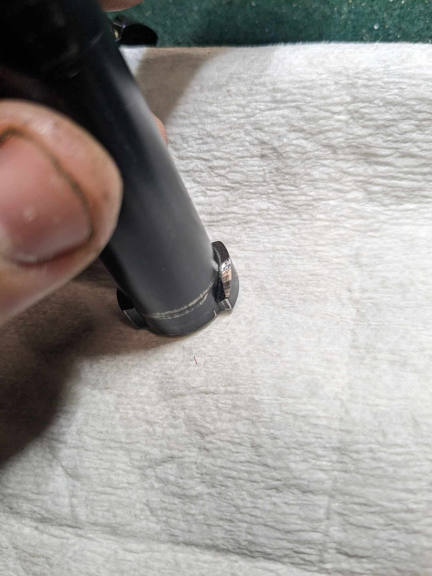

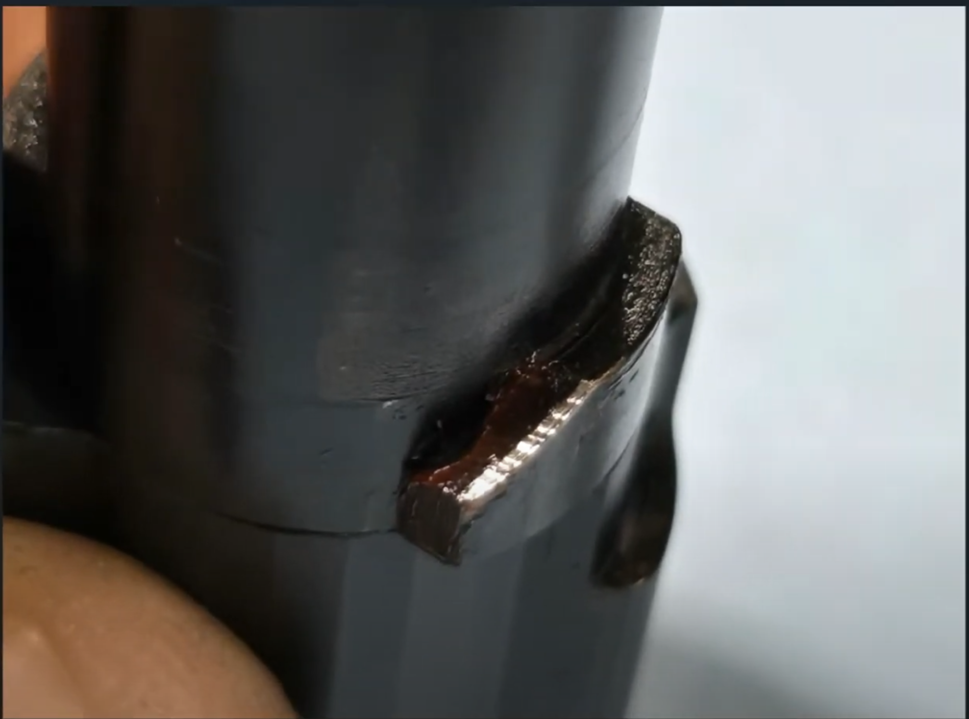

Anyone else experience lug wear on their RimX?
Kenny at Desert Precision Gun Works is currently holding all RimX builds because new actions are showing excessive lug wear on the bolts with just a few cycles on them. Claims the bolt material is too soft.
Live stream on YouTube
To save time go to 5m and 30m ( he shows a brand new out of the box action shows wear after just a few cycles).

His claim is that it’s a recent issue bc of a material change by Zermatt. Not something that would be widespread right now.
But to your point, they also announced their new in-house action will be coming in about 6 months.
EDIT: my mistake, his claim is this has been going on since July. Also, several of his customers are seeing the same issue on rifles he’s shipped earlier in 2024. Also non-clients have shared photos online ( he shows them at 7m mark).
Watch at the 30m mark. He takes out a new action and it binders after just a few bolt cycles.

Yes, I experienced this within the first mag I put through my action (serial: 35XX) which I have had in my possession for less than a month. When the barrel was installed and a round loaded, bolt closure was not smooth. Once the bolt pulled and inspected after the initial firings I noticed the lugs were worn to shiny bare metal with a slight groove towards the outside. I also noticed the lug recesses on the action has chatter marks. Needless to say, I’m extremely disappointed that this has been happening even after being brought to the manufactures attention.
I’ve already sent an email to ZA describing my issue and I really hope they make it right because this is wholly unacceptable from @Zermatt Arms and the only correct course of action I will accept from them is if they send a replacement bolt body made with the original 41-series steel.

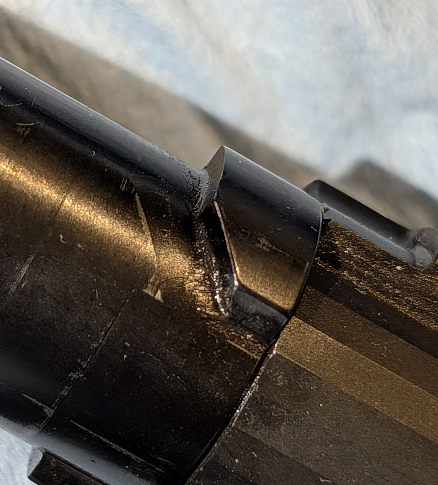

I had an action that had this issue with the locking lugs being “rough” for the lack of a better word. Bolt close felt really bad. It started this way almost immediately after I bought it. I can’t get the picture to transfer from my phone to this iPad, but they look the same as what is shown in the video.
Picture of my bolt. This was reported in late May. I believe that action was delivered in early May.
For me, issues happen with every product. It’s how the manufacturer deals with them. I sent pics to Ray on a Saturday, had a shipping label Monday and the action back in my hands Friday. I shot that rifle a few hundred rounds after getting it back, and it was just as smooth as I was expecting. I did sell it, and to my knowledge, the buyer is still shooting it with no issues.
I bought a new RimX action the week of Christmas. I have over 1,000 rounds through it already with zero issues.
