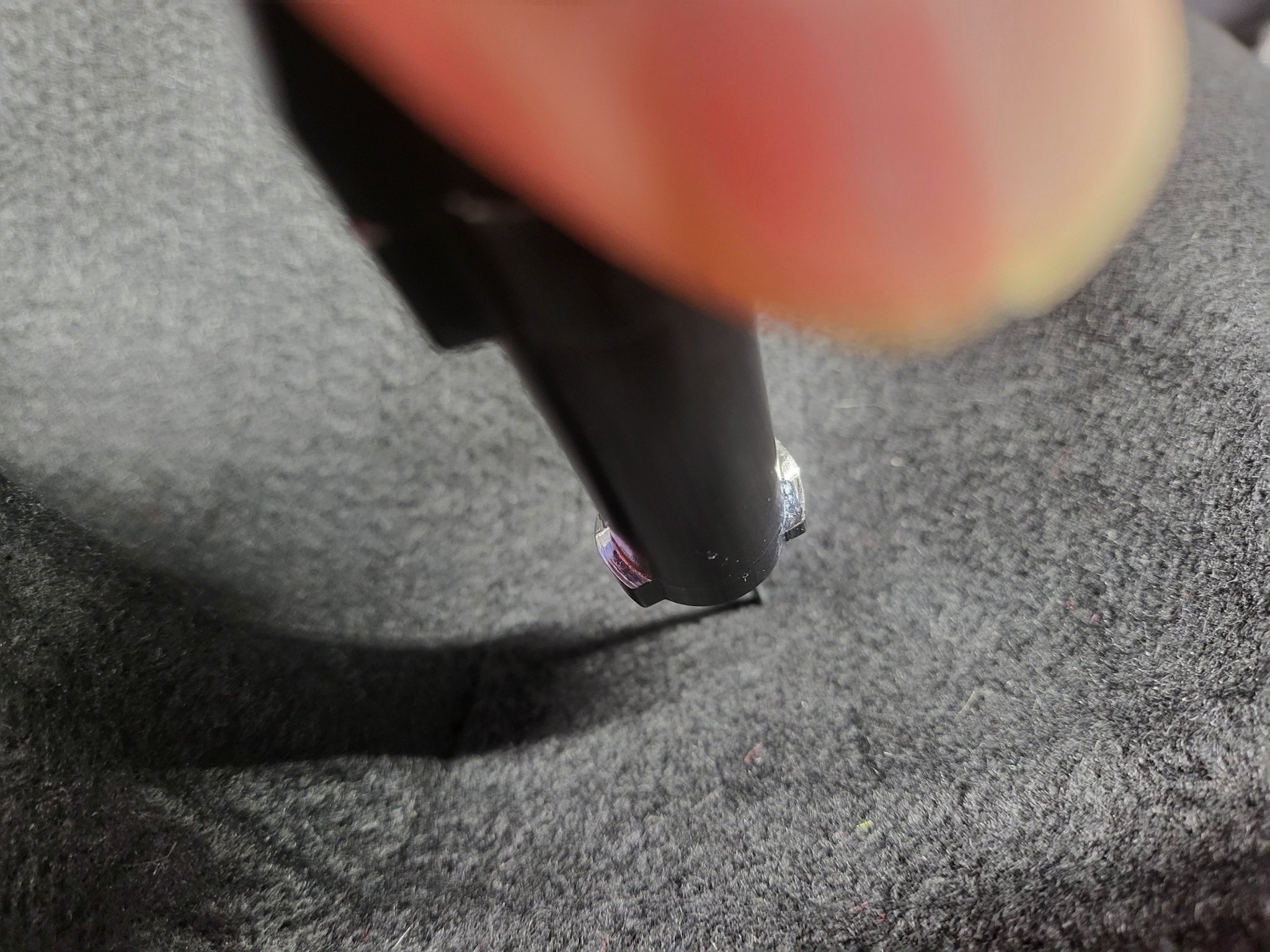

My RimX bolt after approx 1500 rounds serial 03004.

If you are having a problem with a RimX action doing the gouging thing. Email them the pictures and action info. They Will Take Care of it. Ray will stand behind it. I know of 3 actions having this issue. I get contacted by a lot of people as I have owned a LOT or Rifles by LOTS of builders. I put all that info out there about what I own and shoot.
Ray will take care of it if you contact him with an email. I am sure he is as SHOT now and you will not get a response till next week.

I had the issue with bolt gouging (posted earlier on this thread) and contacted Zermatt directly.
I received a reply from Ray within 48 hours, and he sent out a replacement bolt body the same day I received the reply. So as far as customer service, Zermatt is still top notch.
Unfortunately the replacement bolt body did not fix the issue as the lugs are still being gouged. However, Zermatt is working on a fix and will make it right with customers experiencing these issues.

Did Ray tell you what is causing the issue?
