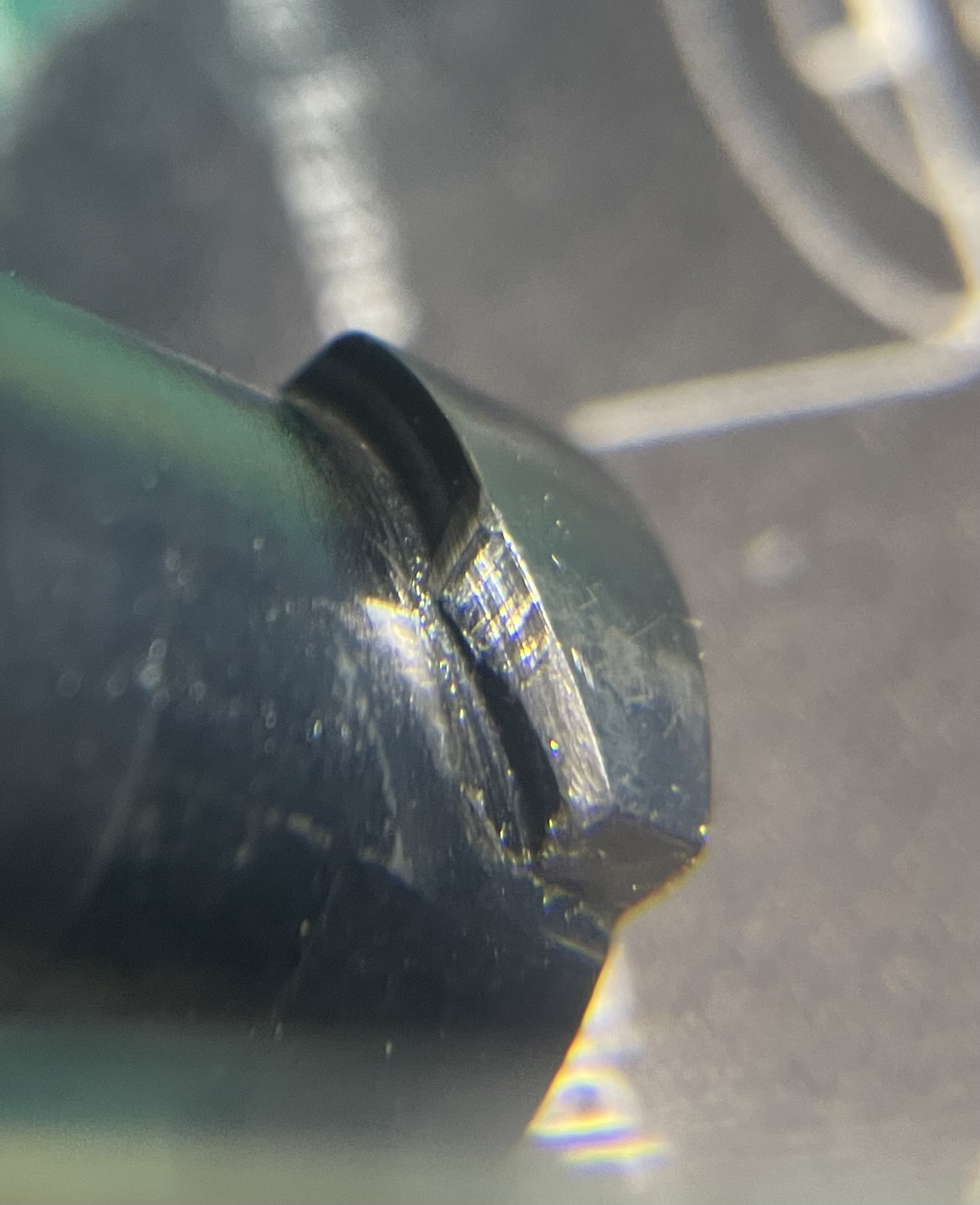

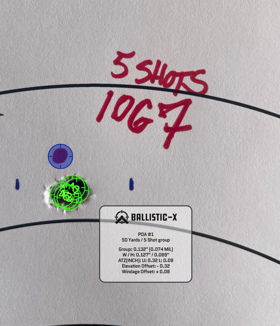

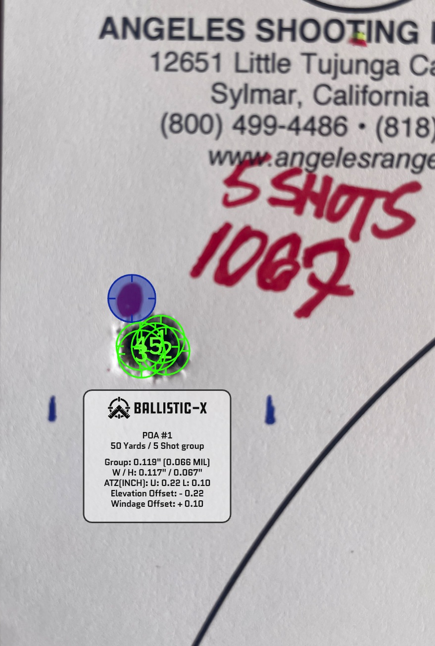

Took it back out today to lot test. It’s wearing significantly, and at times will stick on close. It’s hard to let someone shoot it because they’ll stick it.
But it shoots well.
Yes very odd that some are gouging and some are not. Hard to pin down exactly which ones until they do it.
Wonder if that’s why Ray hasn’t sounded the horn to replace all from such and such SN and above? Must be thinking we’ll just address the ones that show up bad.

If you have the issue, you’ll know it. Bolt will stick on close. Mine is also new. 3500’s as well. This is my first rimfire build so I thought there was some kind of break in period, until it kept happening. Other than that, it has fed and shot flawless so far. Had 4 lots of Tenex yesterday and all shot extremely well thru the PVA barrel. Finally settled on the lot that shot best at 100.

Make sure you clean the action REAL good if you don’t get all the shavings out of the action/lugs it will happen again…ask me how I know this lol…if you have the means I’d suggest you pull the barrel to clean the action.

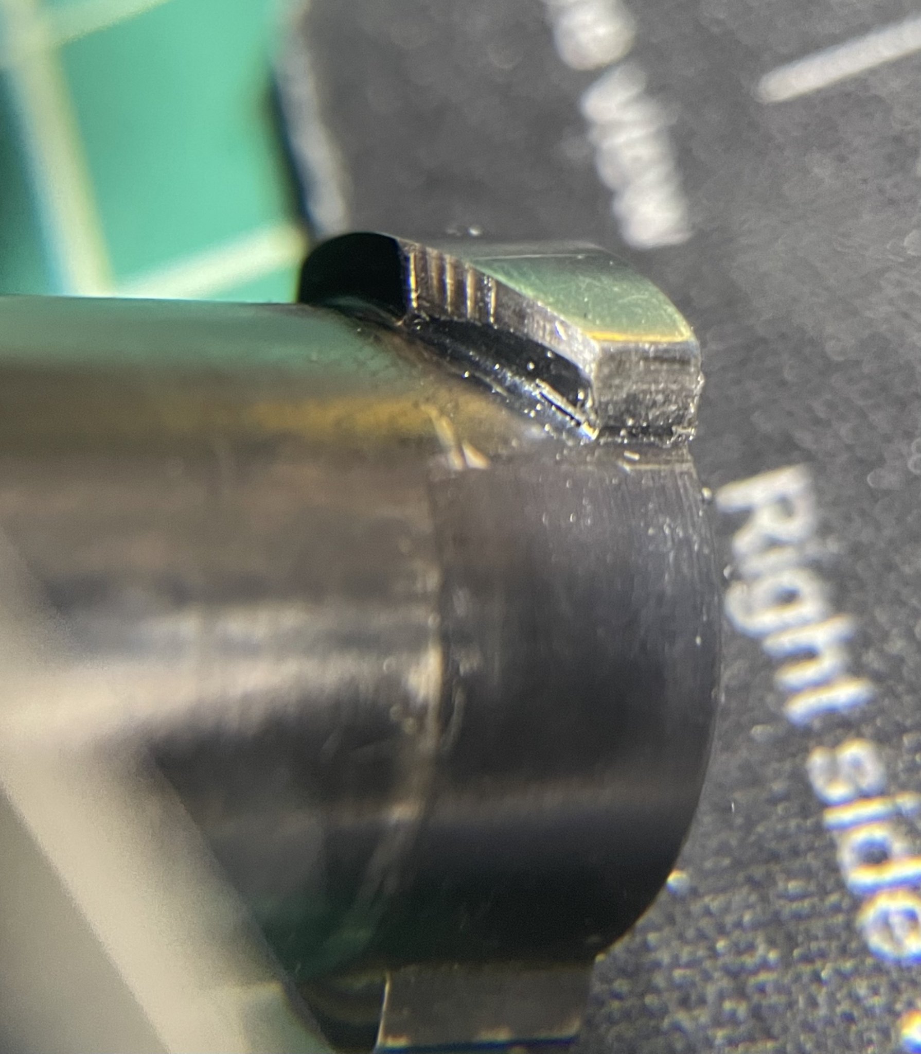

Just picked up my new Rim X 34XX and put it together with a proof prefit. Cleaned up the action, greased the lugs, and worked the bolt idk maybe 50-60 times. I can already see some bare metal on one of the lugs. We’ll see what happens when I start shooting.
Exactly my story! Feels ok with the grease on it but I can see the wear/damage to the lugs already. I’m going to shoot it this weekend and see how bad it gets.

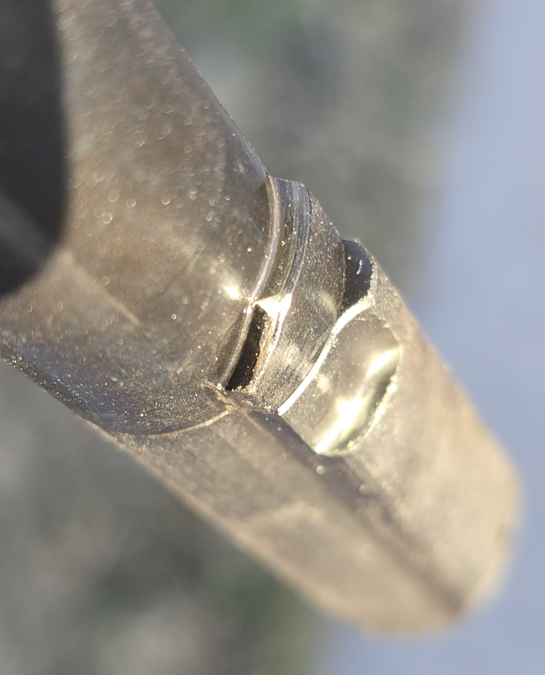

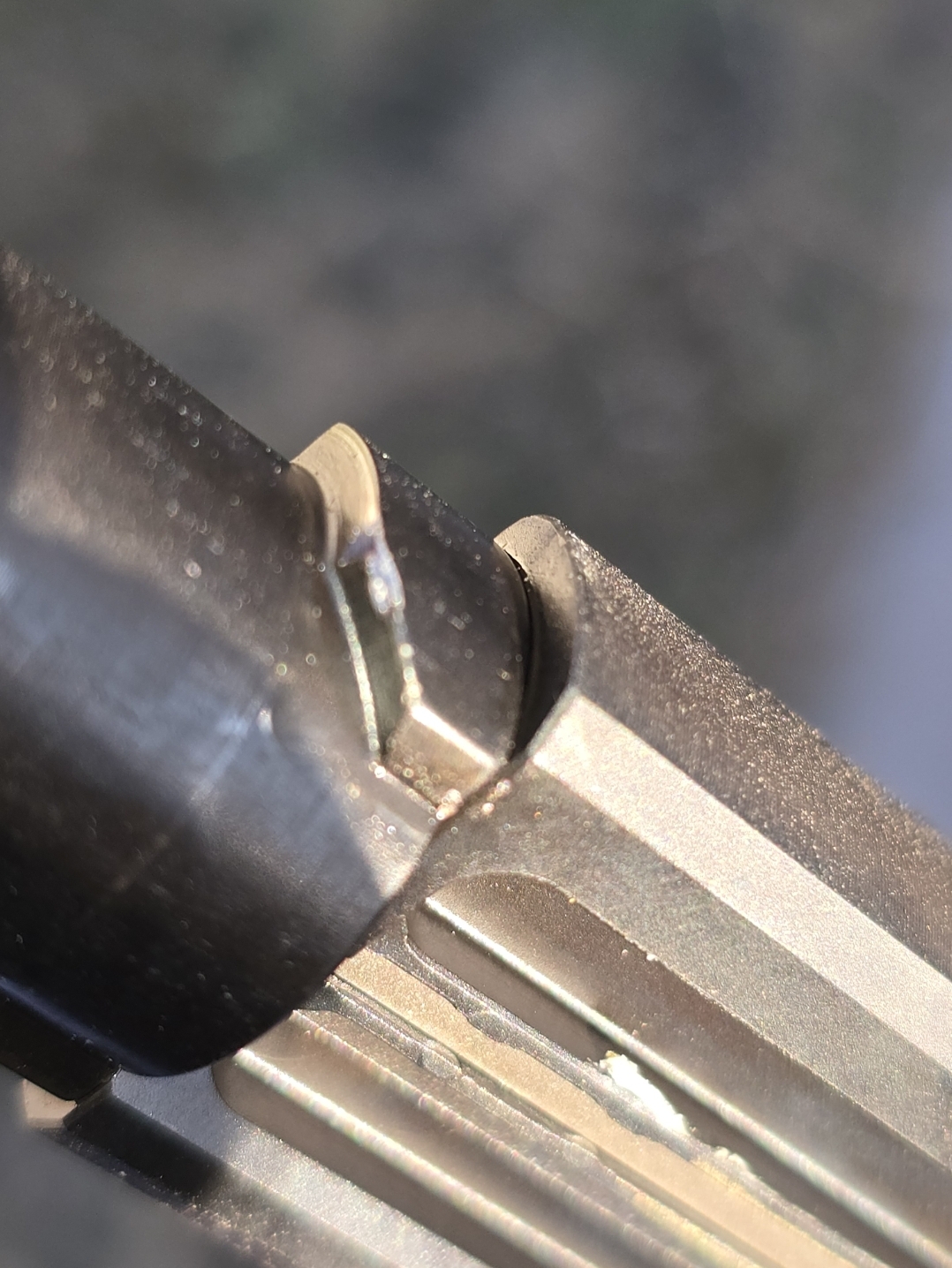

Anyone asking if they greased the bolt. Same for anyone who asked if they properly cleaned the bolt and action. It’s a soft metal issue, period. A fix is coming which has to be, replace the parts. What else is there?
We know it’s a soft metal issue. I can shape the lugs with a nail file. I think everyone knows at this point. Some of us haven’t had the opportunity to run the action full tilt yet, so maybe we were hoping for the best. Not that big a deal my boy.
