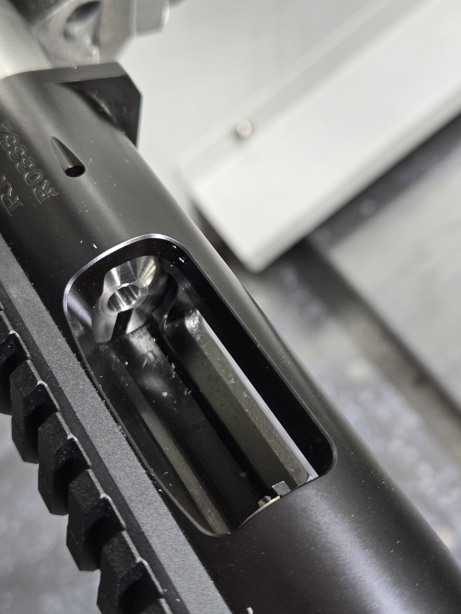

@padom of your 50,000 rounds, how many tensions/extractors have you replaced due to wear? I knew of some competitors swapping them out every 2000 rounds or so to not have any issues with a round not being stuck.
Zero tensioner replacements. Still running my original tensioner. I just recently swapped my extractor for no reason other than it looked like it had a little chip in it and i know mentally I have 50k rounds on it.
The people asking for RimX to make changes to the design of the action so it uses extractors I just dont see happening. Thats the whole reason the RimX design exists was a new design that didnt require timing and cutting extractors and setting headspace for specific ammo... If that happens, prefits are out the window and you have yourself a Vudoo. Every action will need to be sent to a gunsmith for the barrel to be properly timed and extractor grooves cut and you WILL have to set headspace based off your ammo of choice.. There is no way around that if you go the extractor groove route....
Maybe Zermatt comes out with a new bolt head that comes with traditional extractors for people to purchase and then you can send your action and new bolt head off to a smith to have them fit, time, headspace and cut extractor grooves... That barrel is married to that action only forever and prefits are out the window until you swap back to the original bolt head....
Not something Id do and dont find it necessary but gives more options to the people that demand it...

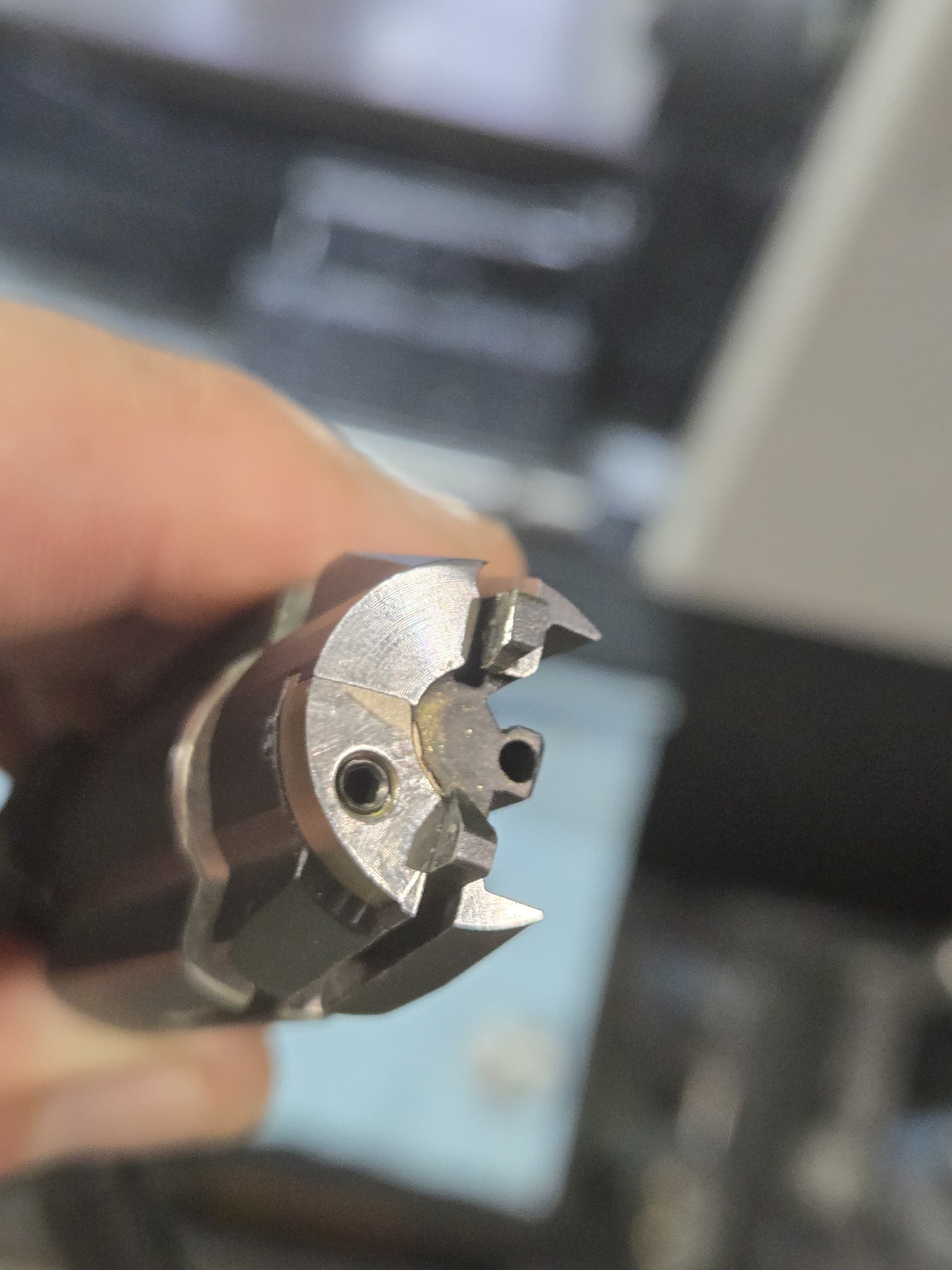

I'd like to see a round "just jump in front of the bolt" I have two RimX rifles (TS Customs/Bartliens) one with 18,000+ (finishing up that 4th case) and one with 2500ish.
#1 is extremely slick, when the bolt is open, and your moving to a new position the bolt can move forward and push the round partially to entirely out of the magazine. Do not pull back on the bolt, establish your position, close the bolt and go on. Understand your equipment.
Exactly! What you just stated is in my experience the #1 issue for malfunctioning of the RimX during matches.

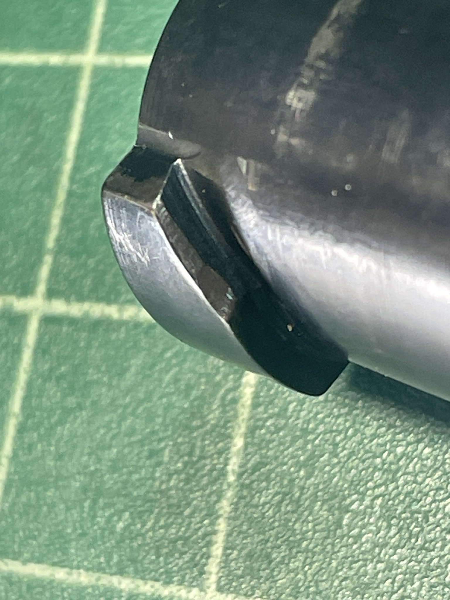

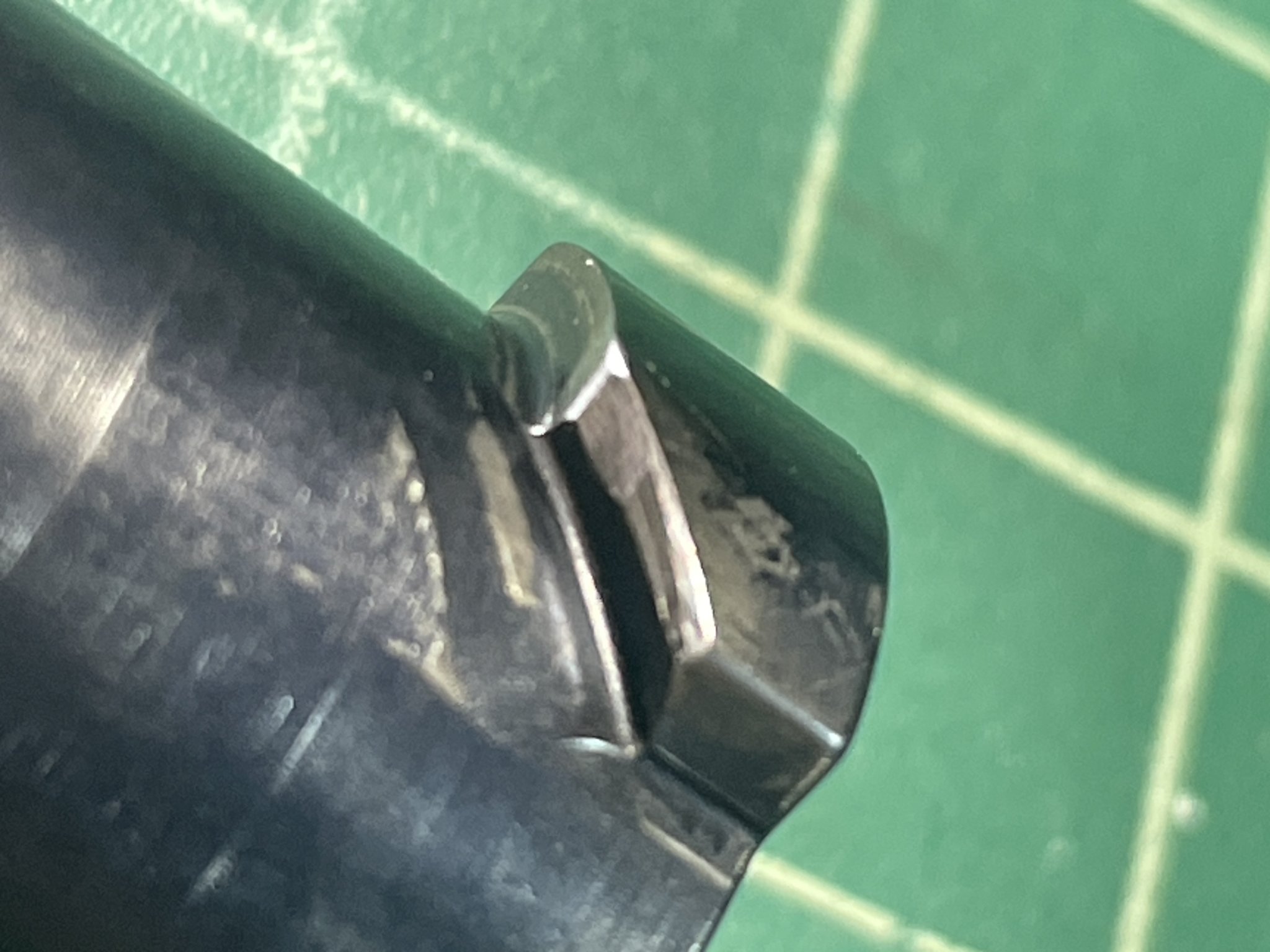

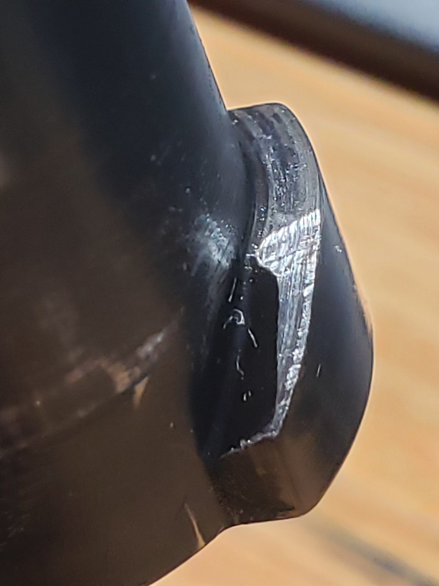

If it wasn't for EagleEyeShooting's video I would have never realized my RimX bolt had an issue, not having any context. I compared my bolt (serial # 3179) to my friend's bolts (2100 serial number range). I was very close to buyer's remorse, but Ray from Zermatt has been very helpful and they believe they are close to a workaround with the newer bolt material to end the premature bolt wear. They seem genuinely motivated to solve this problem.
Here are the lugs on my original bolt after only approximately 800rds. They have since replaced my original bolt with a new one, but after 600 cycles, I am still seeing the same wear pattern (same bolt material and hardness). I am waiting on the new bolt body with revised cam geometry and hardness to be released.

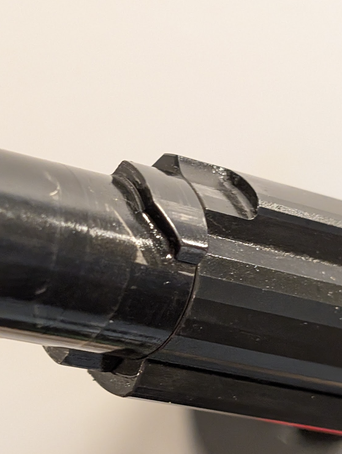

Well my bolt is showing wear like all the ones shown on here. Called Zurmatt and talked to them. I believe that Ray is genuinely concerned about this issue and is taking steps to get it corrected ASAP. Even with the bolt issue the rifle is a shooter.
Bad mouthing a product or Smith isn’t the proper way to resolve issues

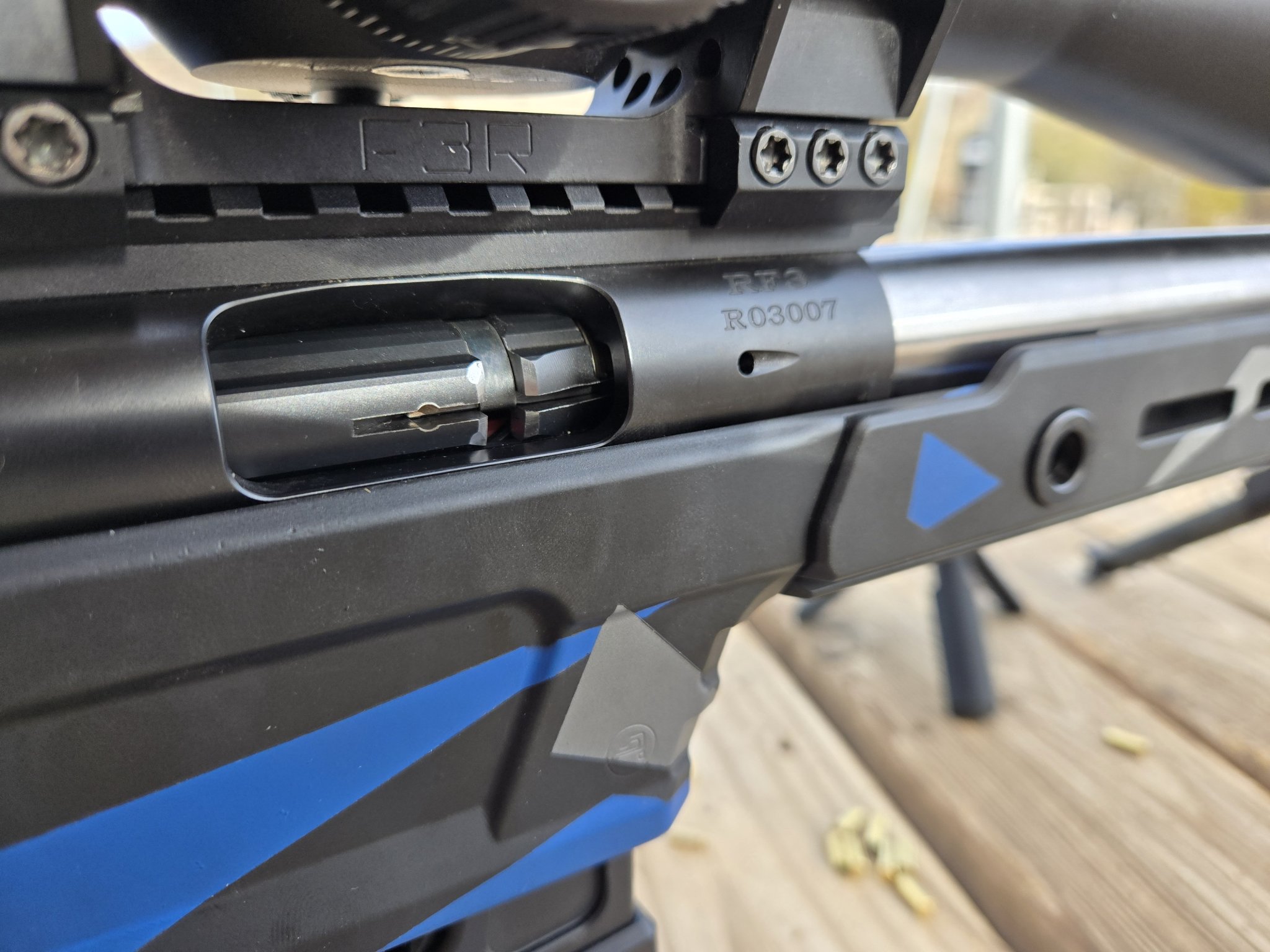

I have 5 actions - All 3000 and higher serial numbers and all but 1 have the issue.
Glad I caught this, was about to start a thread asking about the bolt wear.
This is 200 rounds into a fresh build..
So is this normal? Can and should I continue to use this?
Here are some pictures from mine #35XX. Round count is an actually 45. I tried to get a decent picture inside the action but it’s not coming out. I’m not sure how much of that smear is grease. I haven’t wiped off any grease from the bolt body either. I haven’t reached out to Zermatt, I’ll get around to that. Since they’re focused on a solution, I’m really not concerned.
