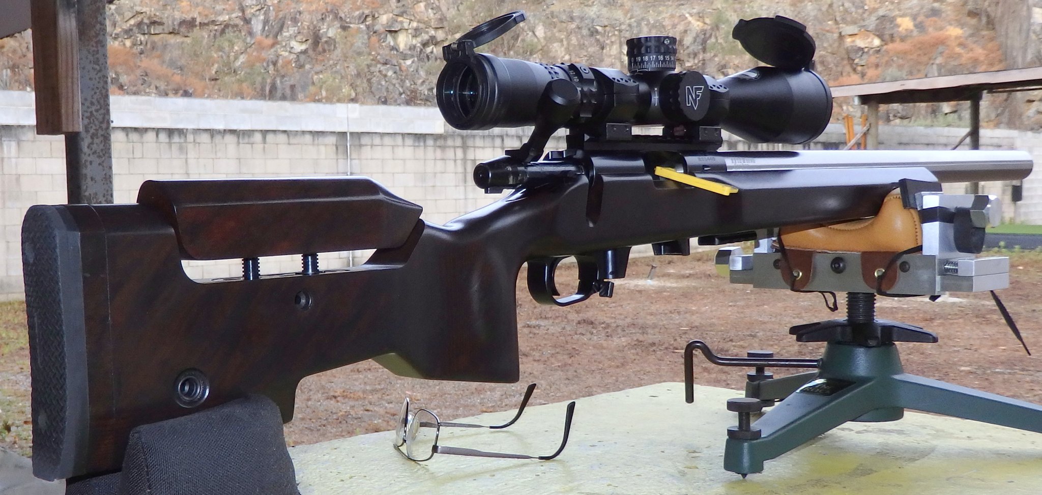

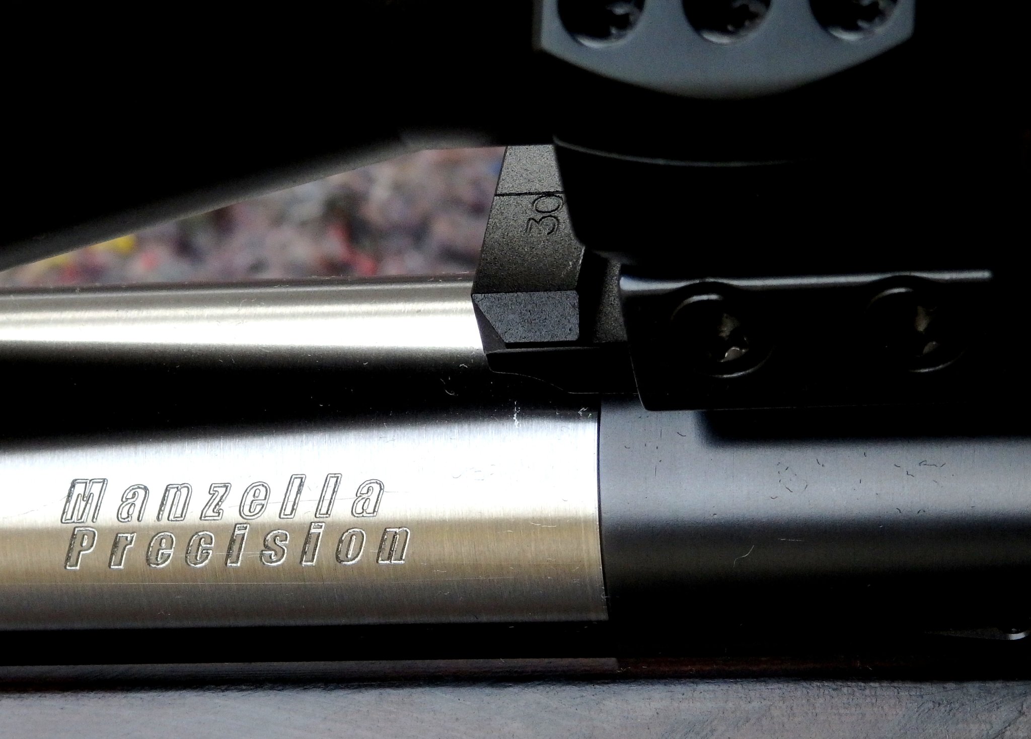

Earlier this year, I contacted Mike Manzella to ask if he could do a pre fit for my Rim X - Normally not a big deal but I live in Australia's Top End.
Mike purchased a Kreiger blank on my behalf as the supplier would not deal with an international customer. He machined the blank and Amy shipped it to an Arizona based exporter in April.
The package finally made it to my door and I put it together this week.
I just wanted to say a big "Thank-You" to this small family run business. Mike's attention to detail is outstanding and his follow up service is as good as you will find anywhere.

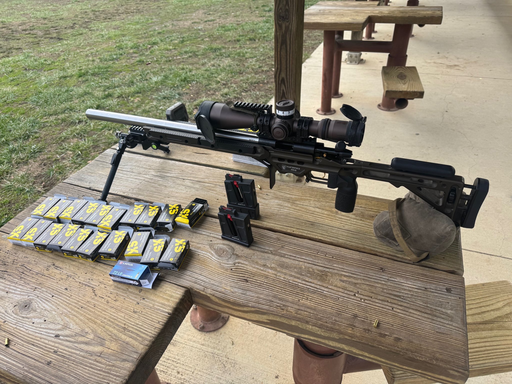

Well, I must say I'm impressed. Took the new build out to the range today for the first time.
RimX w/ a Radix Precision spun 16t 1.2" ACE blank finished at 25" with his custom chamber.
This was not a lot test mission, but more so just a "get rounds down range and season the barrel" type outing.
Mission accomplished.
I can't believe how well this thing shoots at 50 yards. It didn't care what I fed it.
Norma Tac?
Center-x?
Rifle Match?
Super Long Range?
0.2-0.4's all day, and the wind was not dead-calm.
I do have some work to do at 200, as that's where I normally focus my lot testing. The lots of Center X and Eley Match I had on hand shot okay at 2.9" & 2.5" 10 shot groups while managing the wind. Norma Tac surprisingly shot pretty good (~4"), but the ES/SD issues definitely started showing that far out. The two lots of Rifle Match I have did not shoot worth a darn. Something like 8-10" at 200yds. I didn't even bother measuring. I don't really think that can be attributed to my barrel, as my buddy shot the same rifle match lots out of his Duece and saw similar group sizes at 200yds. Bad ammo is bad (n)
The barrel was filled with a hodge podge of different lubricants by the time I was done, so I'm sure I could shrink the Eley and Center X numbers with a calmer day & better "testing" procedures.
Today was just about fun though.
I tuned the mags last night before I headed to the range this morning, and didn't have a single feeding issue. I'll get some pictures of my targets and measurements following the next outing when I'm a little more methodical in my approach, along with some real pictures of the gun.

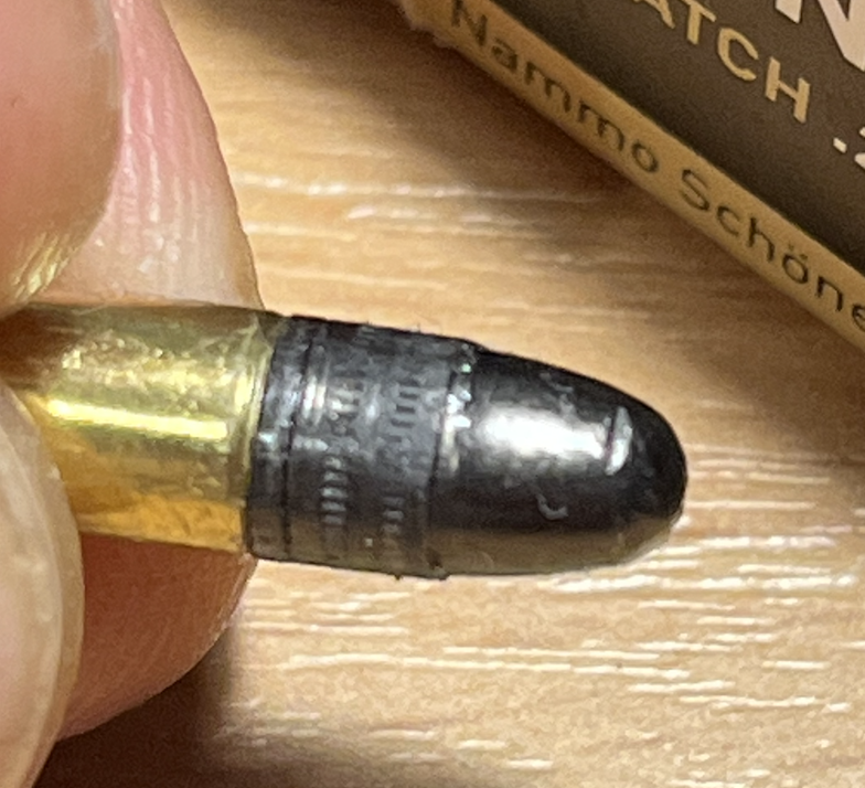

Anyone ever had issues ejecting eley cases? My rimx is flawless with sk and lapua but has the occasional failure to eject (not extract) with eley. Being that’s it’s hard to find lapua ammo I’ve switched to eley…. I did get the eley specific extractor and still have issues. I also ordered and extra power tensioner spring from a guy on the rimx FB group. Hopefully that helps.
I've been shooting tons of Eley Match lately. Bought 2 cases after lot testing and haven't had any issues. Still using my original extractor Serial #005 as well..
