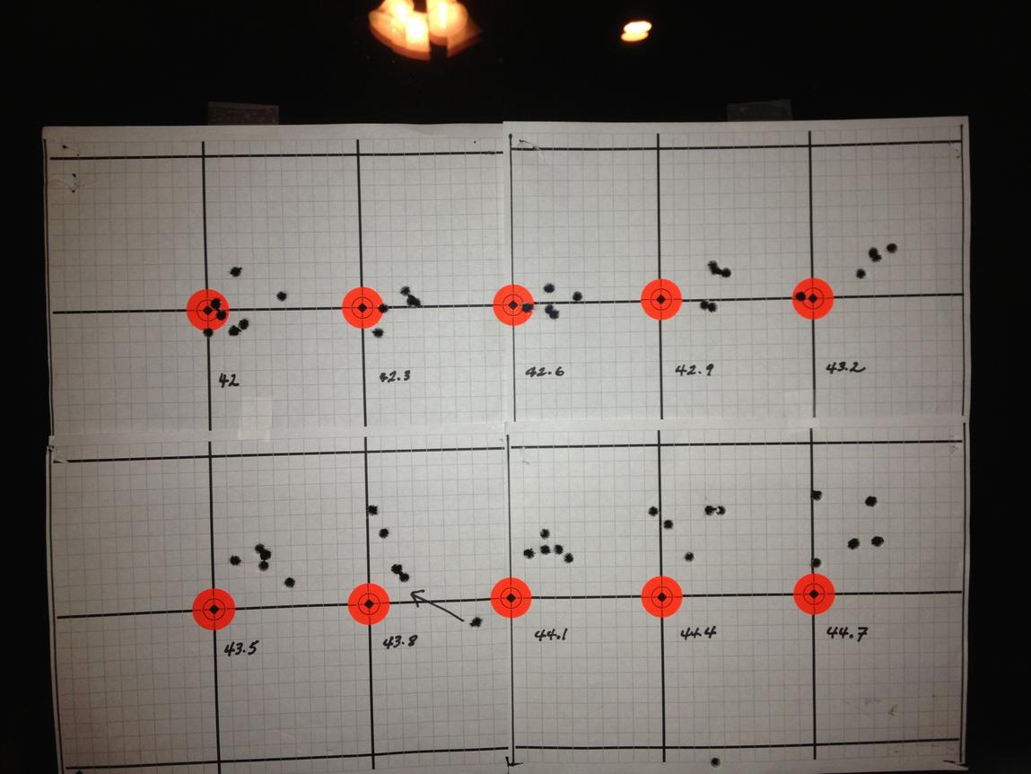

.260 Remington OCW test
All,
Thanks to everybody who responded to my earlier request for .260 Rem load data. I decided to do some OCW testing at 200 yards and here are the results I came up with. Thanks to Flashfire who dutifully captured my chronograph output as I shot my groups.
I contacted Dan Newberry and he helped me interpret my targets. I have a clear scatter node at 43.8 gr. Based on my groups and the fact accuracy nodes tend to be 1.5% above and below scatter nodes he suggested I further explore 43.2 gr by varying the seating depth. There was one flyer but he felt is was shooter induced. Interestingly enough, this load is very similar to the loads shared by others in the this thread which gives me quite a bit of confidence. It also had the lowest standard deviation of all the groups - 3.3 fps.
Regarding the group at 44.1 gr: I was gravitating toward that load but Dan said it was a trap since it was so close to a scatter node. This is the type of load that would shoot well on one day and shoot like crap on others.
I welcome your thoughts on this...
Ed

Know,
I agree with your thinking. Chasing velocity rather than accuracy is a beginner's trap, and I'm glad to hear that you didn't fall prey to it.
I went into all the various places where I could find loads for the 260 using the powder and bullet weight I wanted. Then I averaged ALL the data to figure out what the average charge weight was where the highest number of shooters got the best results. I based my starting load data just below that, and started working my way up. It was neat to find that the load I eventually settled on was only .5 grains different than the average that I found in the beginning. That small variance could easily be because I have a 27 inch barrel rather than a 24, or because I used necked down Winchester 7mm-08 brass rather than Lapua.
I think you will find your load very soon now...varying seating depth hasn't made a huge difference in my velocity as long as I wasn't jamming the bullet into the lands to cause a pressure spike. Going from .005 to .020 thou back from the lands, my velocity was more determined by charge weight than seating depth. When I arrived at the point where you are, I used seating depth and group size, then used the chrono to get my final velocity to save time.
I agree. I start my load development with a ladder test @ 350-450yd then take the most promising node, & round robin (OCW) a few tenths above, & below @ 200. Then take the best of the OCW to seating depth with another round robin. After all that I chrony, & begin testing @ LR while trueing my FFS to the load. I'm usually done in less than 50 rnds.
From what Dan explained to me, the seating depth variations are to adjust group size. To your point, it is not my objective to adjust velocity through seating depth. The 43.2 gr load of H4350 averages 2802 fps. My chrono setup is a CED Millenium II at 15 feet from the muzzle.
I was shootng 139 Scenars - I'll have to see if I get similar results with 142 SMK.
I'd be interested to see what I would get with a ladder test at that distance.
I didn't mean to suggest that you should, (or even could) use seating depth to significantly adjust velocity. What I was trying to say is what Dan explained to you better than I did. Changing seating depth usually gets you to the "best" accuracy within that node or powder charge. Your velocity may change a teeny bit with seating depth, but not enough to make much of a difference. Velocity will only change significantly if you start causing yourself pressure issues by jam seating the bullets into the lands. Few of us like messing with pressure spikes. Many people do jam seat bullets, and many Berger bullets are known to shoot best this way. However, the problems that can occur with jam seating have caused me to use the same method you use...seat a bit back from the lands. I find it safer, and gives me better reliability. Plus, I like being able to use my 308 ammo in both a bolt gun and a semi-auto. Jam seating would be nothing but headaches for me there.
Without using jam seating, I don't risk having the bullet pulled out of the case, thereby rendering my rifle useless, and scattering loose powder through my action. The pressure spike that most people find when the bullet is jammed into the lands is compensated for by a reduced powder charge. I think that loose case necks and gentle jam seating is what most bench rest shooters use, but the single feed rounds, and often load at the bench. Obviously, that won't work for our kind of shooting.
I have been reloading for many decades, and as time goes on, shooters keep learning more and more about ballistics, reloading that helps accuracy and other issues. Just like with precision rifles, advance keep happening with rifles and reloading....both equipment and techniques.

What is wrong with 42.6?
All,
Ed
I'll be eager to see your new 260 when you bring it out. (or maybe post some photos)
Hi Unknown,
It was a simple barrel swap on my AI Arctic Warfare. I got an AI barrel so it looks just like my .308. It is slightly heavier by a few ounces due to the reduced bore size. I've only put 60 rounds down the barrel, but so far I'm liking it. Much less recoil than my .308 shooting 175 SMKs.
Take care....
Excellent question because I was orignally drawn to that group.
Dan said that since it is almost 3% below my scatter node at 43.8, I could be very close to a scatter node similar to the group at 44.1gr. 3% below 43.8 is 43.5. To confirm his theory I'm going to work up some loads at 43.5 and see what happens - I expect to see another scatter node. Also, the velocity averaged 2750 which was a little slower than I wanted to be with my .260.
My chosen load of 43.2 gives me 2,800 fps which should give me decent barrel and brass life but is also fast enough to accomplish what I want to do.

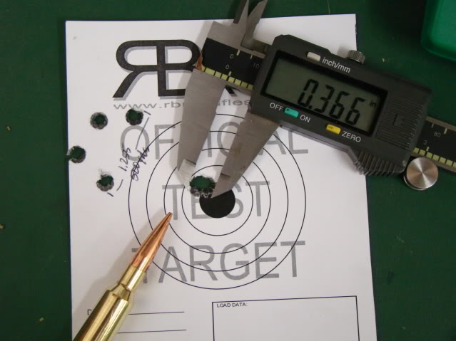

Not nearly as impressive as Travis or Jakes RBros groups but here's 42.3 ( Yea I have to be a little different) at 300 yrds
I shoot one hole groups at a 100 all the time but the other four shots after the first always screw it up ;)
