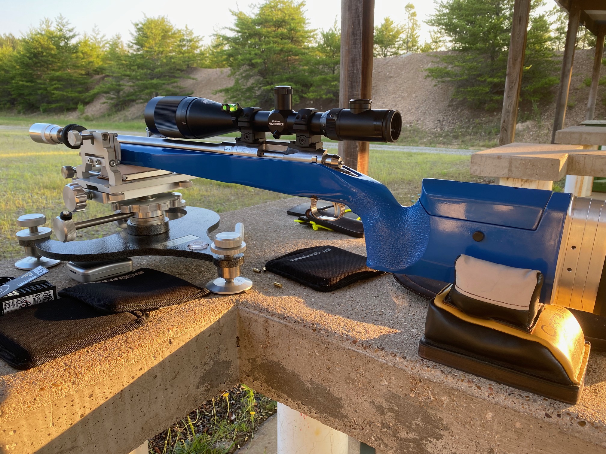

Good morning Bill W.
I have the Kestros Stock as well. Love the Single Shot V22S with Ace 22" barrel.
I am curious what ammo you use and how you set up your free recoil.
My best score so far on our BR Target is 250/21x. I have had several 250/20x. More common is 250/16x or a bit more.
Last Thursday the wind was quite switchy.
Right now I have been using Eley Match Black Box. Weight sorted to 0.02 gr.
Curious as to what is working for you.
Stay Safe and Well.
Stay Safe and Well.

A fun shooting day. Shot both the Benchrest Match with my V22S and the 100 yard Mini Palma with my Gen 1 Vudoo Repeater. Shot both matches in less than 30 minutes. Shooting quickly! 45 shots on Mini Palma. 15 per target. As per normal, 25 on Benchrest.
4Certain
View attachment 7696167View attachment 7696168
GOOD shooting my friend! Wait till you get your rest!
