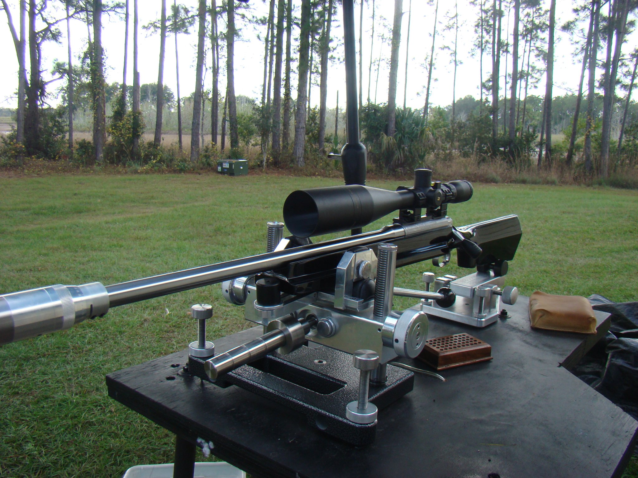

I use a RODZILLA T-REX front rest with the 5 axis top and a Protektor 3M lined bag in the rear. I've been experimenting sighting the target then coming off the gun and watching the flags, waiting for the appropriate wind, then firing. I watched it on Youtube and thought I'd try it. I shot a 250-11X the 1st try and that was with quite a wind. I love experimenting!
The VUDOO is still in preparation so I shoot with the Turbo V3 while waiting.
On the V3 the trigger is a Flavio fare 2.0 very nice but indeed the trigger weight should not be too low, I am set at 0.06lb to avoid unintentional starts.

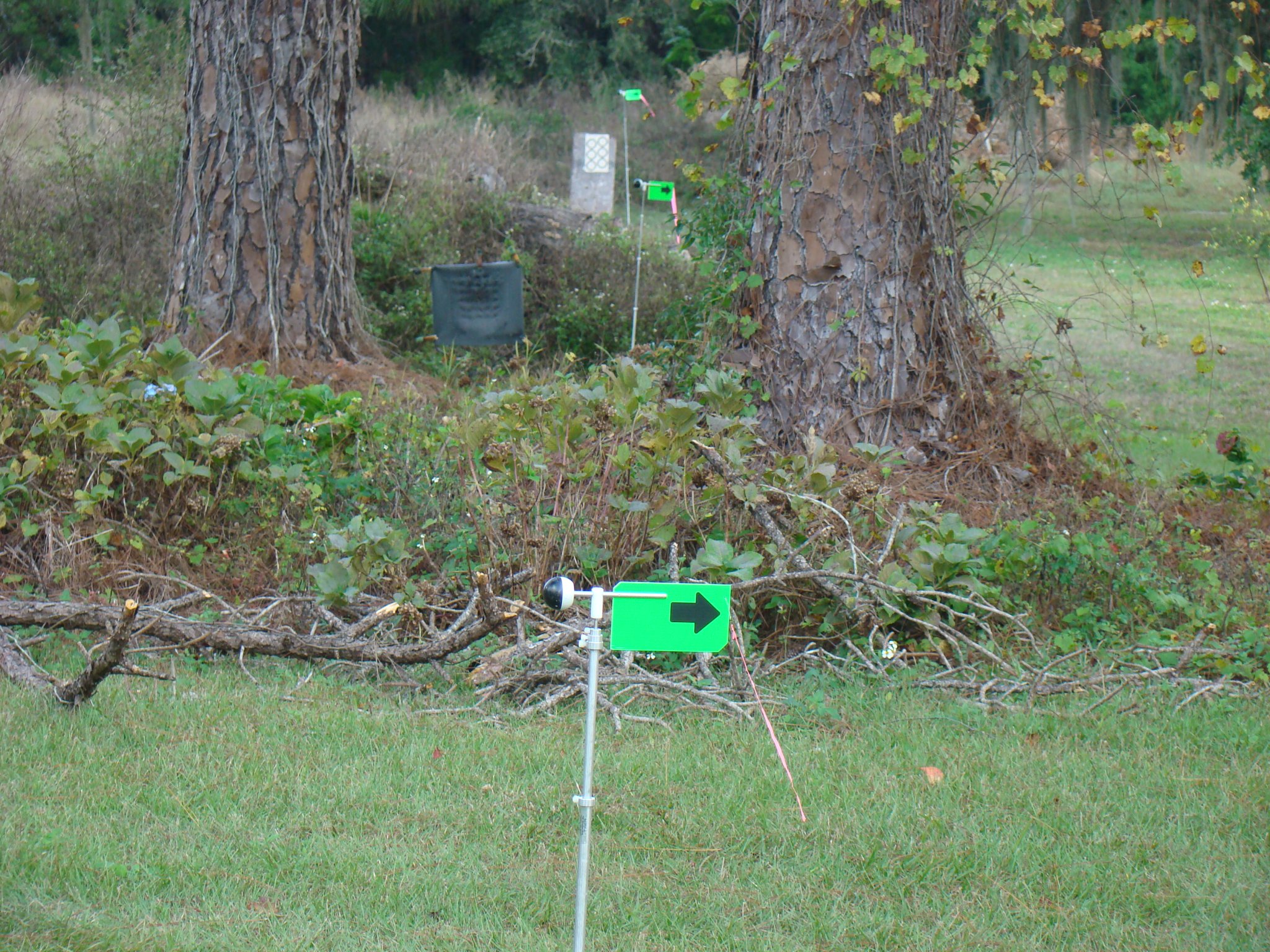

I shoot in free by looking at the weather vanes, the finger is placed on the tail of trigger, the departure must be ordered instanly so with a weight of departure too low there is a risk of unwanted departure.
Saturday and Sunday we were in a friendly competition, the weather was very windy, rain a hail storm and therefore it was necessary to be the finger on the trigger to ensure a departure at the precise moment to have the possibility of placing a 10 or a fly.
It was a good time to train in all weather conditions and to choose the ammunition that behaved best.

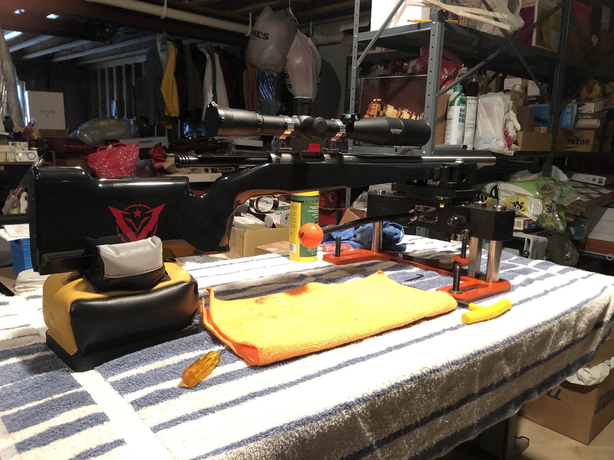

G’day all, I’m a long-time reader but first-time poster.
I am a 3P and prone shooter who recently purchased a Vudoo V22 single shot to dabble into benchrest. So, I have little to no experience in shooting bench so please excuse any ignorance in this post. I also must apologise for my OCD in testing as I have an analytical mind also.

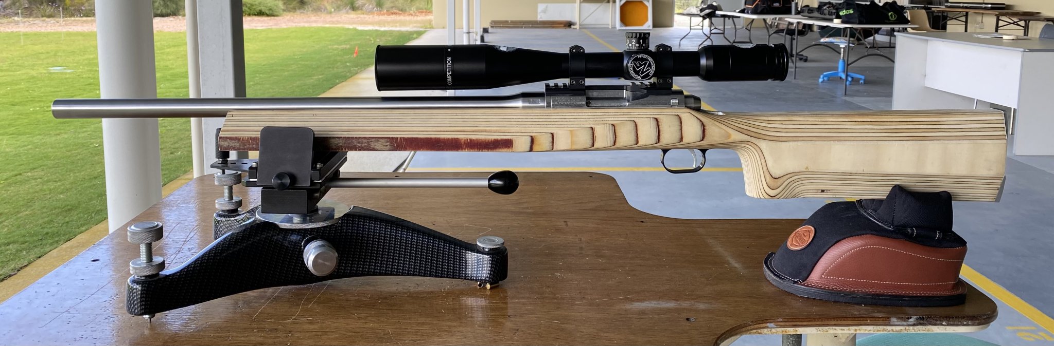

I purchased a stock from a local stock maker Just Ask Geoff (JAG) which is named the ST1000. Geoff was very helpful and did an amazing job on the stock so there was very little that needed to be done during bedding and finishing.
This is the initial set up of the barrelled action in the stock;

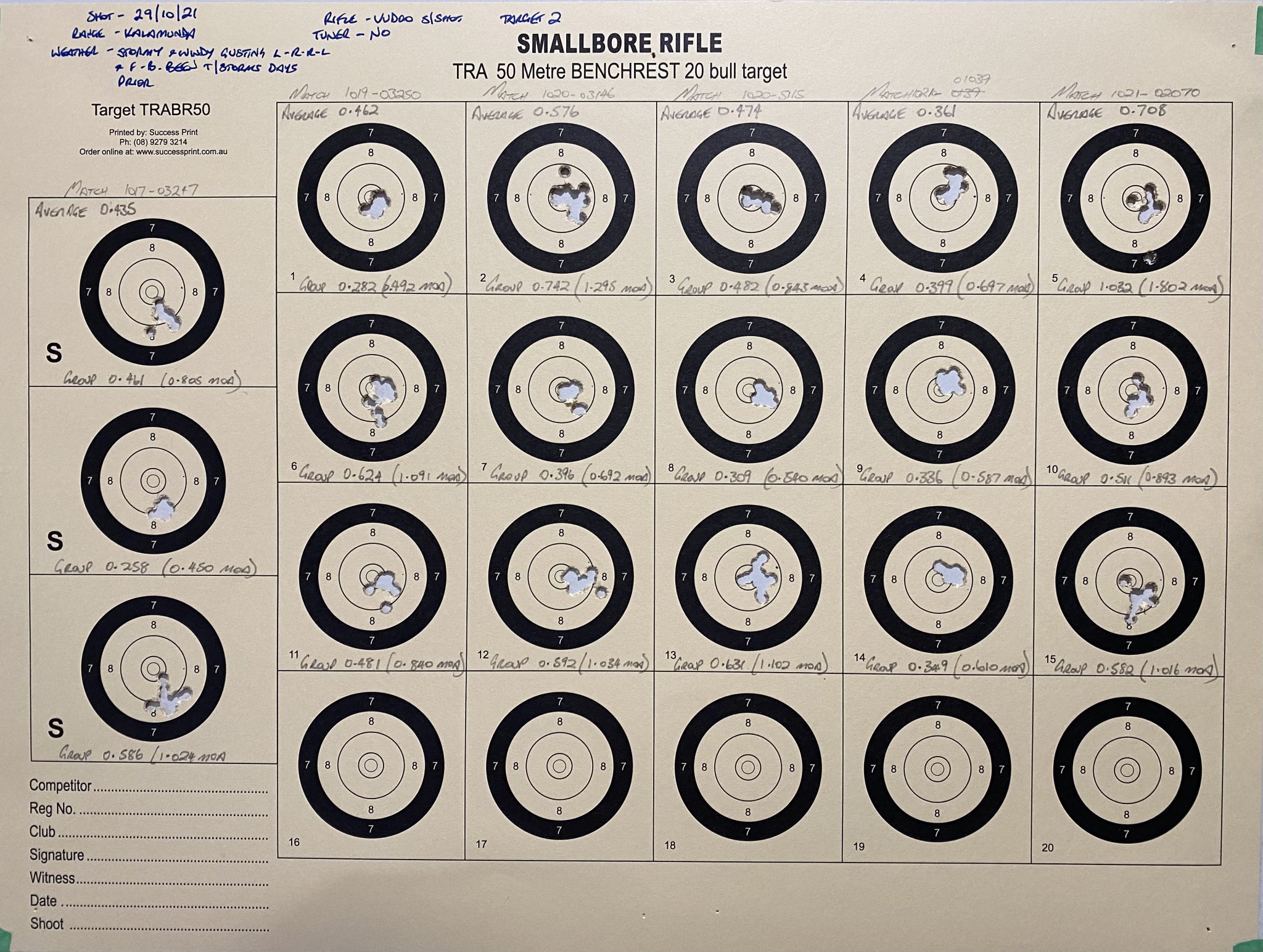

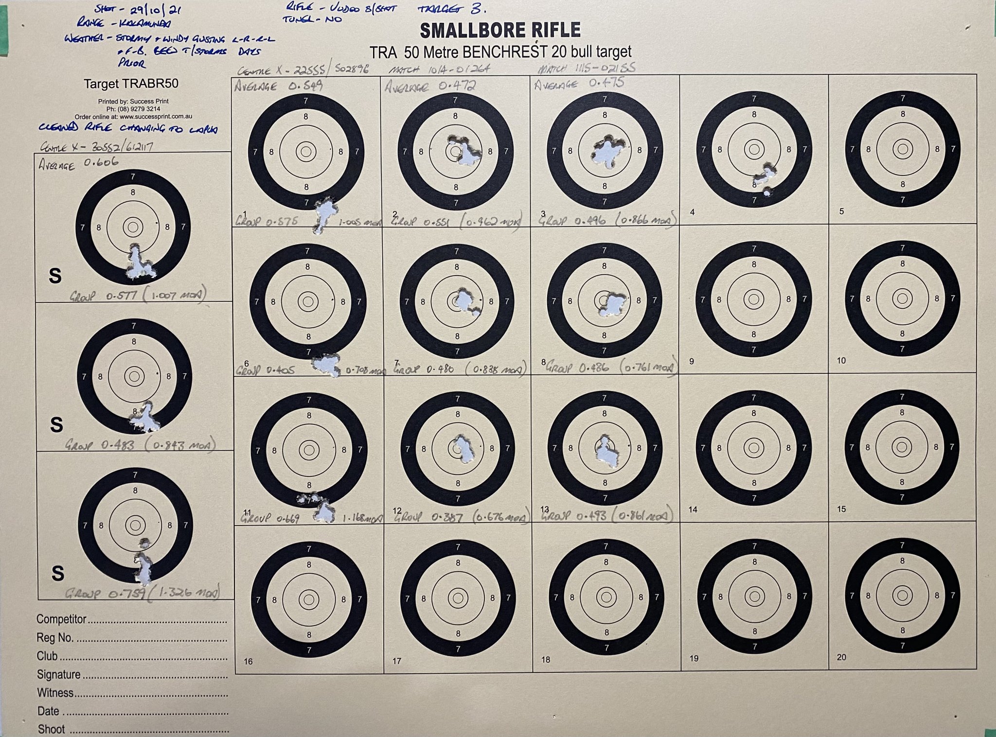

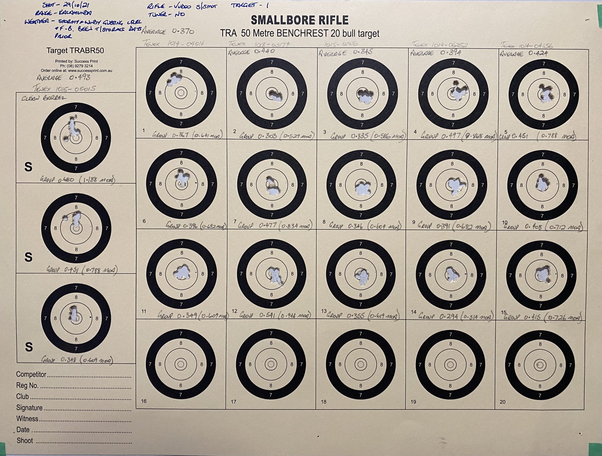

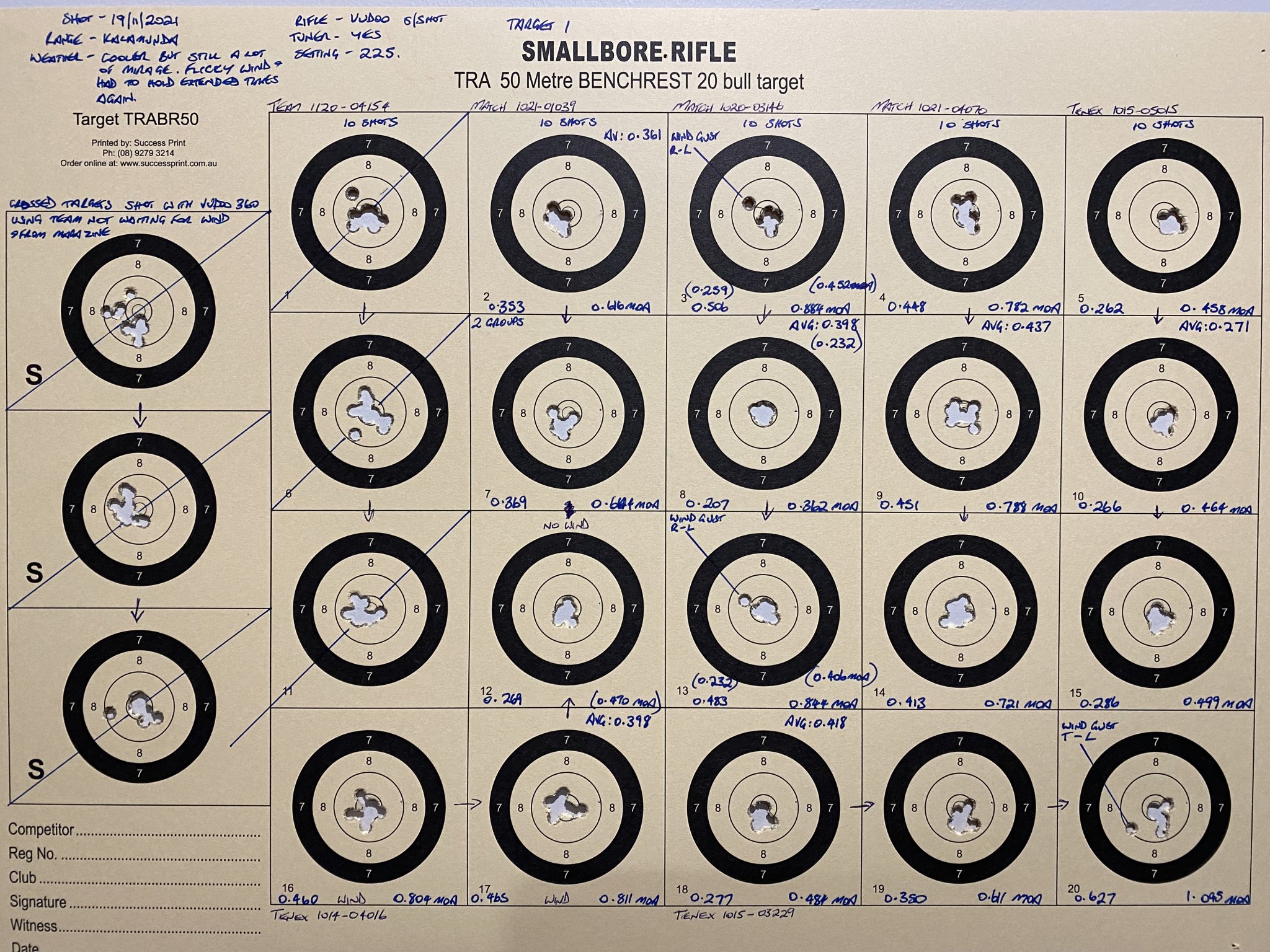

Due to not wanting to test tuner with ammo that didn’t shoot in the rifle I conducted these initial tests with batches of ammo I had on hand to see what shot the best. I don’t believe a couple of 5 shot groups give a true indication of how rimfire ammunitions shoots so I shot three 10 shot groups for each batch of ammo to give a better indication of what actually shoots well.
All targets were shot with the same aim point and I must admit I was pretty disappointed with the Lapua Centre-X as all the batches I was able to test didn’t shoot well at all, even though the Vudoo’s are chambered for Lapua.

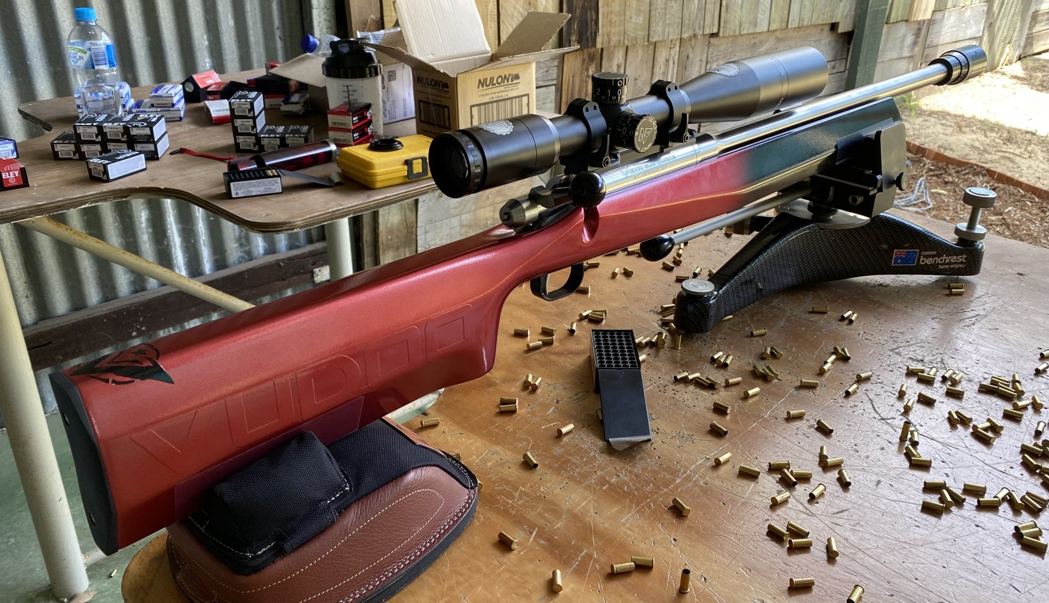

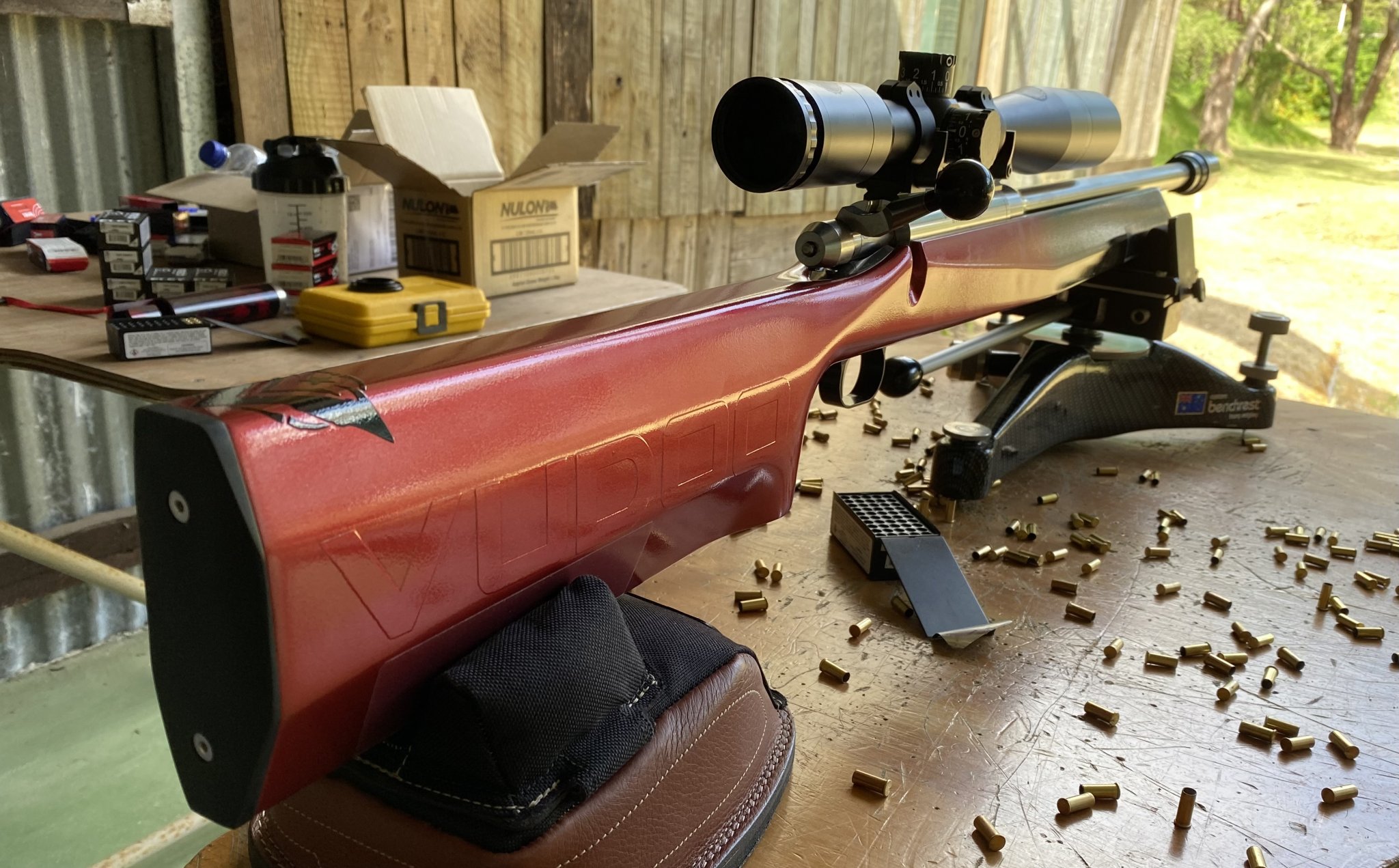

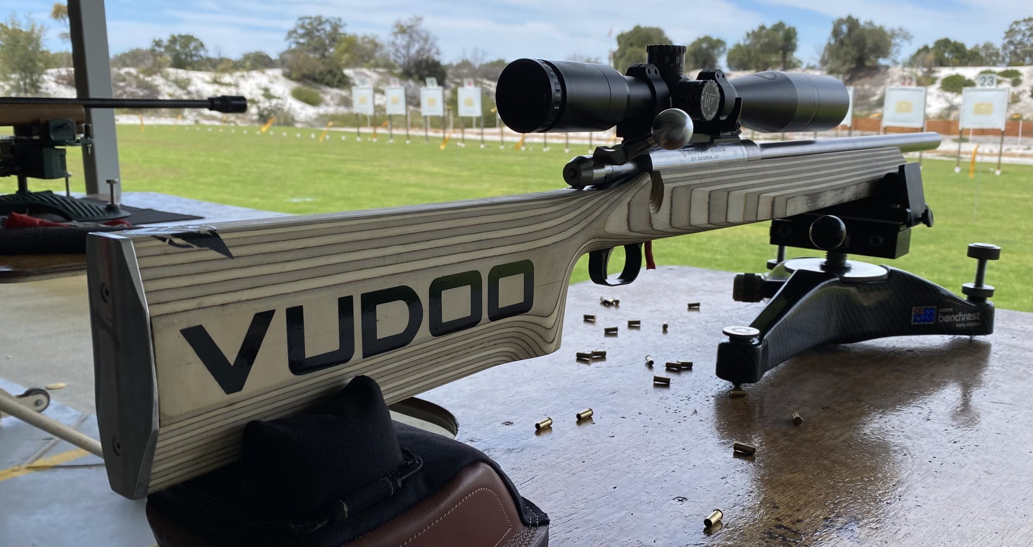

Realising that looks count for fifty percent of accuracy I added a few stickers to the stock to make it look better prior to finishing and painting it.
After deciding on the colour scheme for the rifle this is the finished product

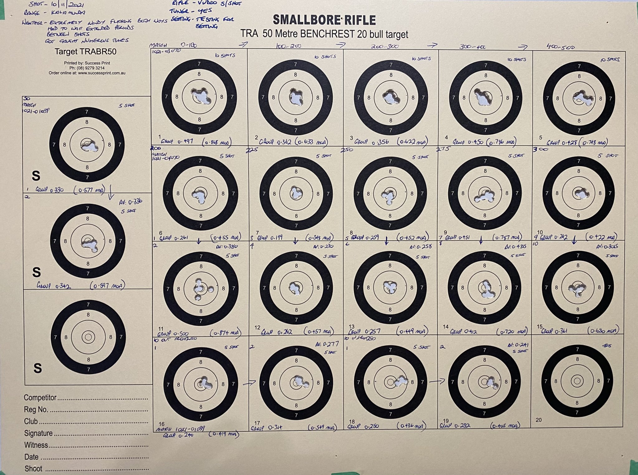

I use a Starik tube on my smallbore rifle and have tuned that rifle utilising the positive compensation method.
I have a Harrell tuner for this rifle and attempted to use the same process. However, this method did not work at all using the Harrell as the results were not repeatable.
Therefore, after a little advice from Jason LOWE at Lowey Products, who also made some amazing bolt protectors and bore guides for the rifle (pics to follow) I used the Hopewell Method to tune the rifle.
This showed a node between 225 and 250 but on this day I chose the 250 groups and played further with that setting. The issue with this day was the wind was terrible and I really struggled to hold the groups together.

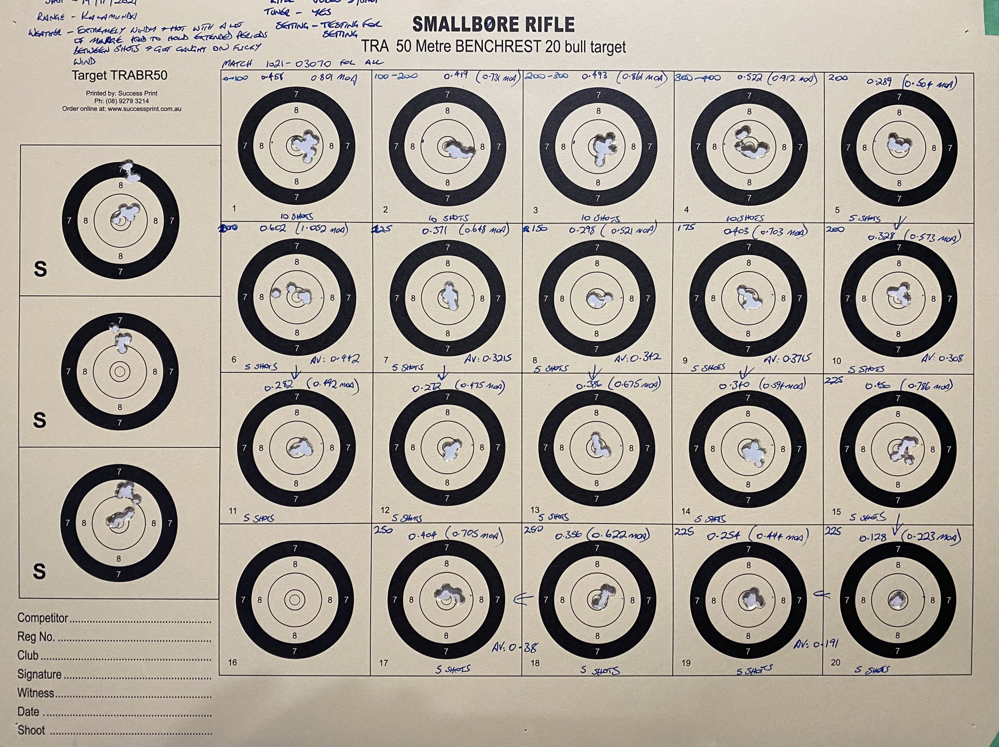

I then conducted another Hopewell Test to confirm these setting and found the following;
After chasing the 100-200 setting I wasn’t totally happy so I went back to the 200-300 range and fell right back at the 225. However, the 125 was also not bad either.

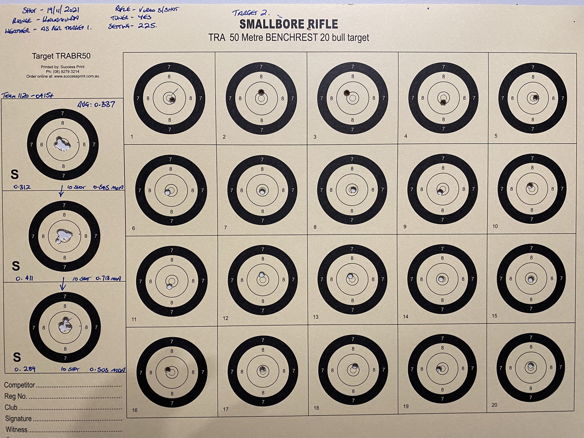

Therefore, I settled on the 225 setting and began testing further batches of ammo I had on hand.
Again, there are three 10 shot groups of each batch of ammo as I don’t trust a couple of five shot groups. The weather was extremely windy again and I got caught a few times but did my best to hold the groups together;
I had some Eley Team which shoots well through my repeater so I thought I would give it a crack in the single shot and this was the result. There are three 10 shot groups on the left and then obviously one shot per aiming mark on the right. Again wind killed me but I am slowly learning not to be so impatient.

Please post some new targets when you get a calmer day from a wind perspective. Also, did you settle on 225 as your selected tuner set point?
RFS99
Hey mate, yeah it’s that time of the year where not only do we get swirling wind but we also have to contend with the mirage. When I get a better day I’ll definitely post some more.
I settled on the 225 as it seemed to be the sweet spot on two different days. However there seems to be a spot between 225 and 250. I played a bit in that range but kept coming back to 225.

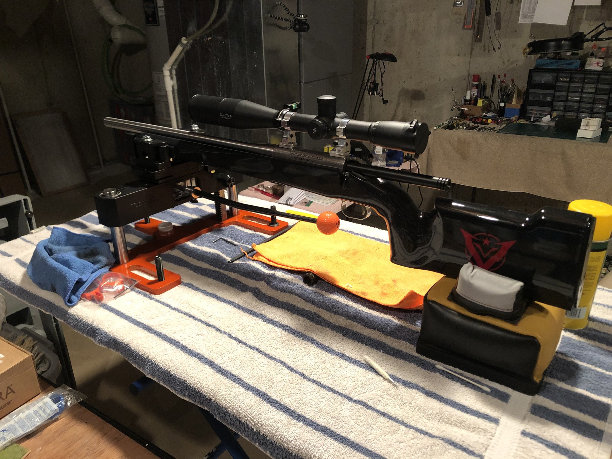

Here is my rig and some range shots from today. The target is 100yds, Florida style. I'm preparing for a 100yd match this Wednesday.
