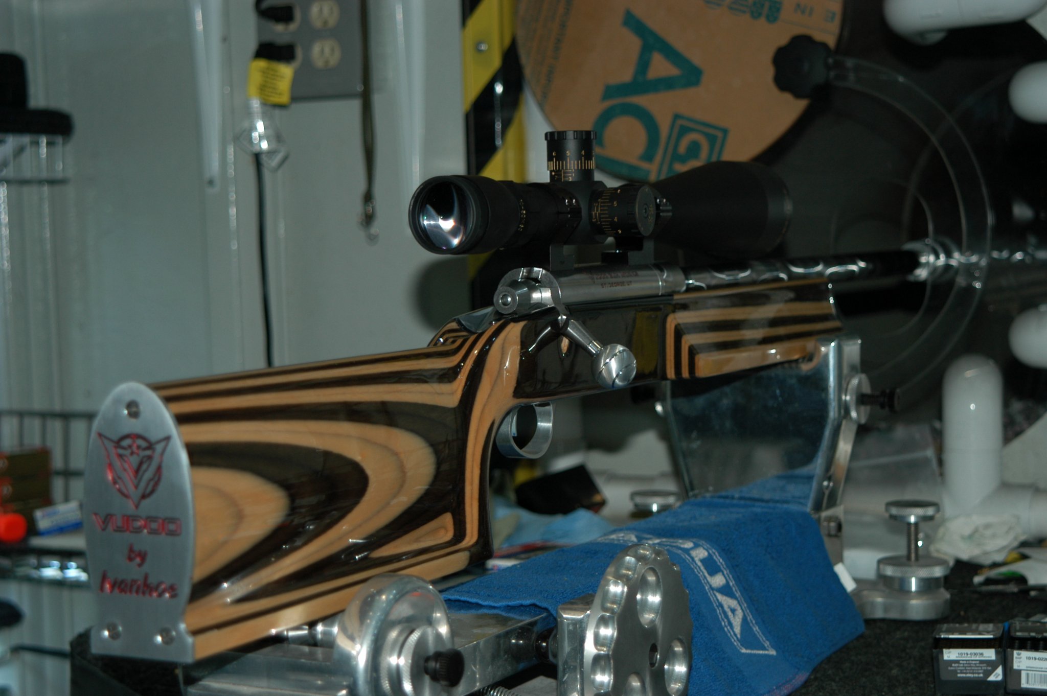

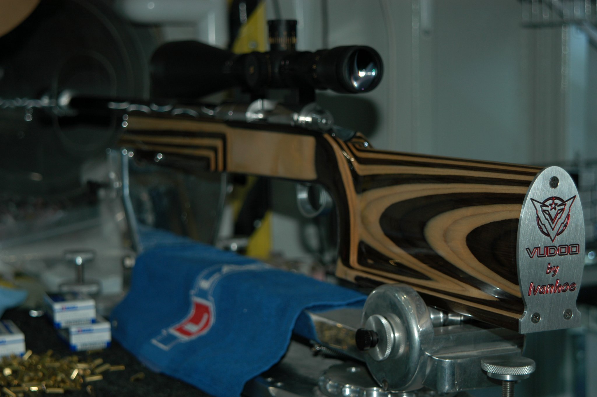

I will post some hard data by the end of the week. Until then a few more photos for you to enjoy.

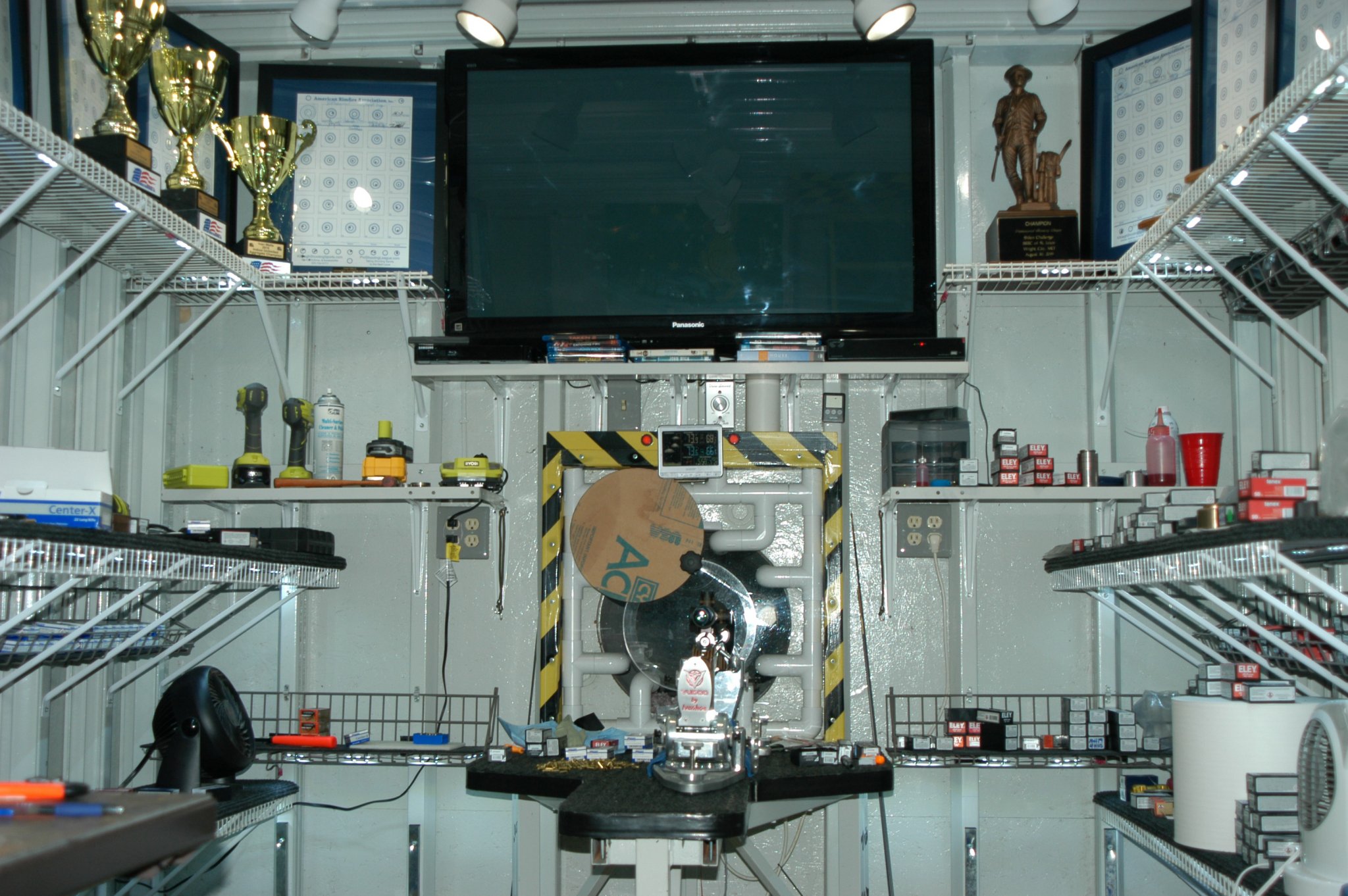

C:
If that is your mechanical mount and there is nothing you wish to keep proprietary at the moment, would you please show photos and describe its features.
C:
Yes, that's Ivan's One-Piece rest he designed and fabricated. The controls are similar to most of the rests we use, but he's incorporated some innovative features that are unlike some others.
I'll leave it up to Ivan to explain farther if he wishes, because I'm not sure what he considers proprietary or not.
Here a somewhat better pic of it when I was down there a few months ago with one of my rifles sitting in it.
Landy
Landy

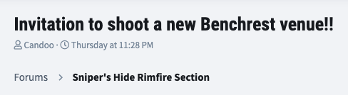

Ivan and Mike are signed up for this, Ivan reposted the match from (I suspect) the organizer.
Nowhere have I read they are behind it.......apologies if this is wrong.
Of course we're behind it. Ivan developed the target and overall format and we're teamed to get this out there with more to come to the BR community.
MB
Reactions: Magikhands and dwt
MB
well damn....I stand corrected.
so, out of curiosity, why the new venue as opposed to the primary 2 sanctioning bodies ?
No worries Dude, I hope I didn't sound brash, as that wasn't my intent.
Because it's time to pay it forward so others can learn, enjoy, have fun and be welcomed.
MB
Reactions: dwt
MB
